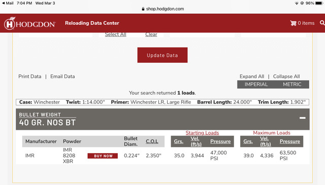

Does anyone know if 8208 XBR can be used in place of 8208? Is there a big difference? I have an 8 pound jug I would like to use for my 22-250 Hornaby 40 grain varment rounds. Gophers really feared the loads with Varget.

I received a notification from IMR some time ago that the powder I had was dangerous, IMR 4700 SSC . They offered to replace my half used 8 pound with any other powder they carried. That’s why I have the 8208 XBR. It came from the IMR Company. Thanks for all your answers. I’m feeling good about using this as if were just 8208 as per my Lee reloading manual.
