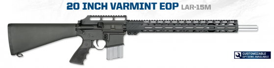

I use a Rock River EOP. I did not find it complicated when I installed
the Kreiger barrel. The beauty of the EOP is being able to use a scope
with a large objective lens with short rings and clear the forearm rail,
and extra stiff also......If money is limited, they probably have a part your
looking for to suit your build.
