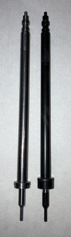

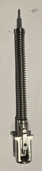

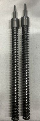

Photos
Dwight kit shown on 1/4” pin
Custom Pin and Spring complete
Modified Bat pin for .250” fall (I trialled this first before I made the custom pin)
Custom pin compared to modified BAT .280 pin
