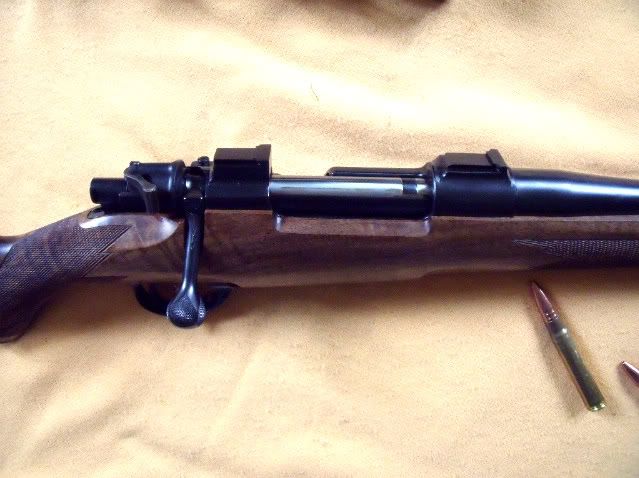

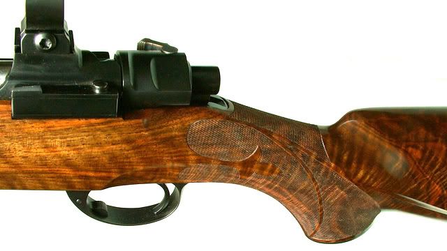

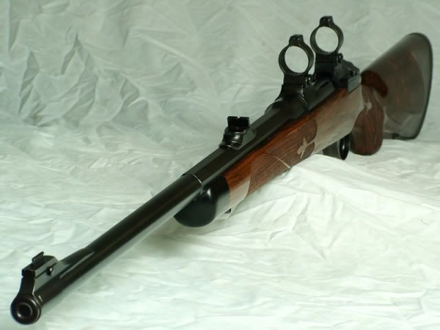

I can't completely agree with you. They can be built and work great with a lot of different cartridges. My first was a Mexican in 17X220 Swift. Should have rechambered it and kept it.
My 7X57
9.3X57
9.3X62
a $3500 Mauser receiver
458 Lott
I have a few others, but done right you can use a big cartridge in them.
