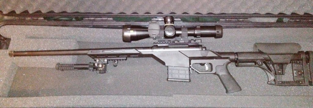

Stealth with New Stock - Luth-AR
Ammo - Seems to like Factory 140 ELD-Match Hornady - 2710 FPS. Also 140 ELD-Match and Berger 130 seem to be doing well in reload. Right now seatinig 2.186 on ELD-Match with 41 gr H4350. Further testing Monday. May work up my last 20 Berger 130's also.

Impressions after 160 rounds.
The rifle is considerably lighter than RPR, that can be good or bad depending on what you want to do with it - Primary mission if you will.
Fixed stock is a win for me.
Rifle is well constructed, fit and finish are good.
Instructions and web site support from Savage have a way to go. No magazines listed (last I checked), no stock replacement instructions, adapter not on web-site, etc. It took over 2 weeks to even get listed on web-site.
Magazines - MDT holds 8 rounds, feed is ok, AICS I tried worked much better. MDT max length approx 2.8
Have a Magpul AICS 10 round coming tomorrow, I believe it allows 2.86. Will post how it does in this rifle.
For those thinking of replacing with a fixed stock - Highly recommended in my opinion - I tried it first without the MTD fixed stock adapter. It worked with the Luth-AR but was not a smooth transition and back of hand could force up against the 90 degree angle behind thumb.
Went back after getting adapter in and redid stock. At 49 bucks plus shipping it is expensive, but looks so much better, I'll try to get a picture before the 4th of July.
Caution - the buffer tube for fixed is an A2 type. Be real careful, it is easy to mess up the tube. Look under the back near where the buffer tube meets the rifle. There is a set screw. Manual does not show the Stealth only BA so this is yet to be proved, but I think you want to loosen the set screw before trying to remove the buffer tube. The buffer is on tight (much tighter than AR's I have worked on), so if you loosen set screw and the buffer comes off fairly easily (like an AR) that should confirm what I am seeing. Wish the manual mentioned that.
