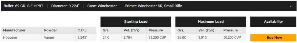

varget has always been an easy button for me with the 223. There is an accuracy load for an AR in their app for load data it’s 25.3 grains with the 69 smk. In lapua brass with a cci mag primer just touching the lands in my 30” barreled rifle runs exactly 3018 fps and has about an es/sd of 10. Been very consistent for me, run it out to 800 yards with MOA accuracy easily.

But I would go ahead and grab some Varget to test those 69 SMK against your other stuff, just to see how the extruded powder does versus the ball powder.

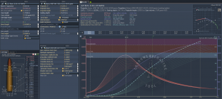

I also ran a 24" simulation by stuffing the case to 102% and let the code plot a ladder down from 26.5 grains. You will not hit pressure, it makes fair velocity, but it will also be spitting a lot of unburnt powder.
I don't run 2000MR so I don't know how it runs with compression, but the plots below also go lower in steps.
