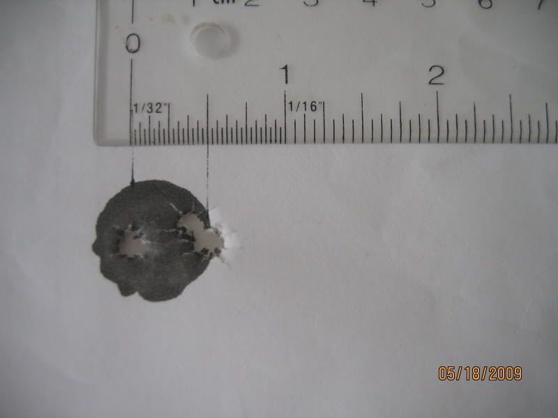

I don't know anything about measuring groups, so I can't say what it is. I just slapped my calipers on it and it's between .345 and .346 edge-to-edge.

GSPV: If your edge to edge group measures .345', subtract bullet dia. from that measurement and your group size is .102'/ Excellent!:)
If you look in the original picture, and count the 1/16ths, you can see that it's a skosh more than 5/16 =~ .3125. It's over because I didn't get the zero fully to the bottom of the bottom hole.
A single holes looks like less than .243. So, I don't think it'd be fair to subract bullet diameter.
Hopefully, we'll get good weather Sunday and I can punch some more holes...
GSPV: One of your previous postings: ' I don't know anything about measuring groups, so I can't say what it is. I just slapped my calipers on it and it's between .345 and .346 edge-to-edge'. I used the information you provided to give an idea of a simple, quick method, without investing big bucks in laboratory quality equipment that is necessary to arrive at measurements to the 'Nth' degree. If that is what you are now looking for, I suggest you invest the big bucks in one of the measuring devices that are used at 'The Super Shoot', and elsewhere. I myself am satisfied in using Minute-of-Angle as a reference.
333smitty said:
Looks like a fine .340' group. Give us some rifle and load info.
Think you might wanna look at that group again. Looks like a small to mid one to me, and I'm not one to give much credit to internet groups. I see bunches of folks post pictures of high ones with a notation on the target indicating a zero group. The second group pictured is damn close to a screamer...if it aint.
333smitty said:
The group size in post #1 appears to be 2 and 1/2 bullet holes.
243 + 243 + 120 = 606 - 243 = 363 If its a 22 it would measure
approx 330
My bad if I am missing something....
It's a 3 shot group in a sideways Mickey Mouse. The extreme is on the two vertically-oriented holes. They're overlapping. It's just hard to see because it got down into the back 'dot' and there is a stray horizontal line there where I had to go over the 'crosshairs' and dot with a Sharpie because my printer's black cartridge was getting low,and I'm too cheap to throw them away and print again).
If you look really close, you can see that the zero on the ruler is very close to being tangent to the bottom of the bottom-most hole.
I asked about estimating groups over on BR Central. Two fellows said that a good approximation is to measure the extreme and a single hole in the same paper and subtract the single from the group's extreme. I'll start going down that route.

333smitty said:
GSVP My bad. Your group is a screamer.Thats one fine lookin rifle. Enjoy.
Smitty, I understood the mistake. No problem here. Friend, I'm so green, I don't even know what a screamer is.

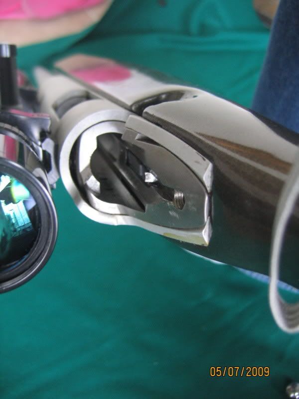

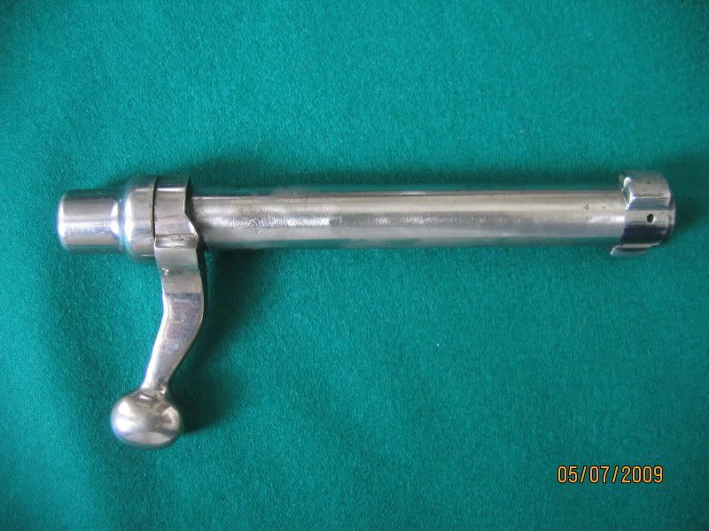

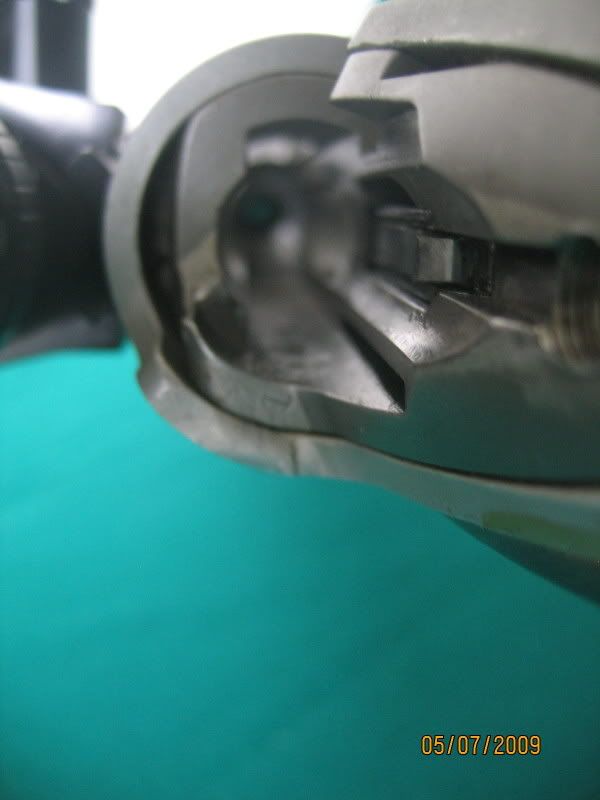

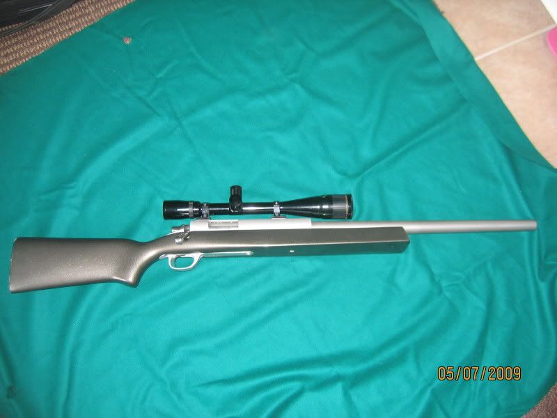

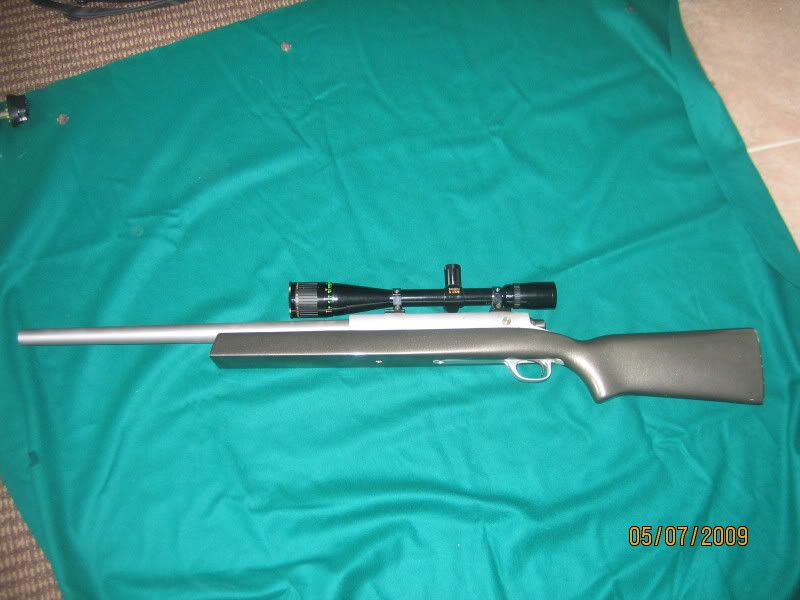

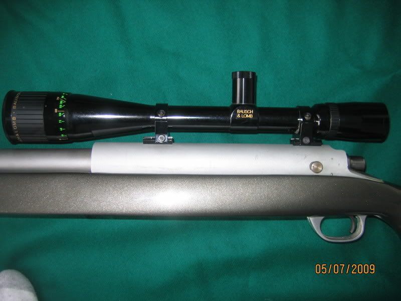

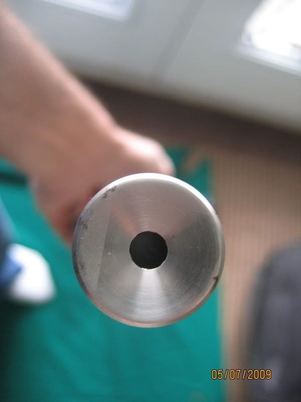

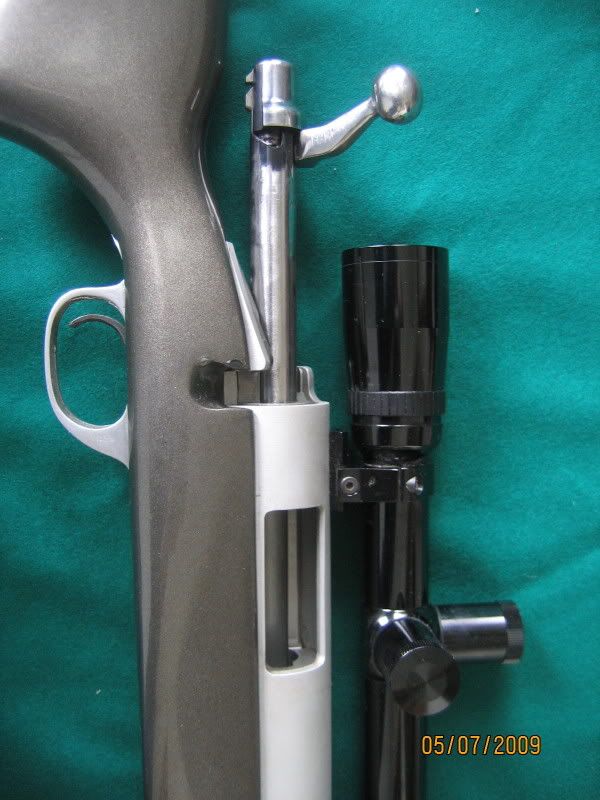

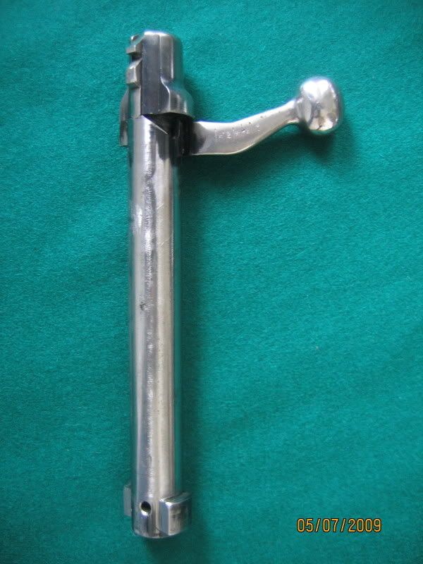

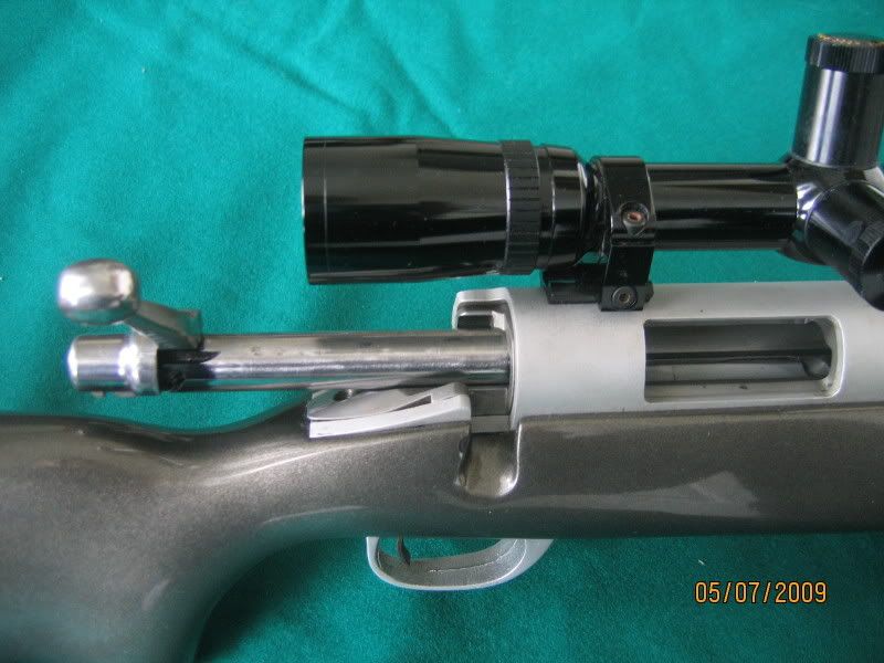

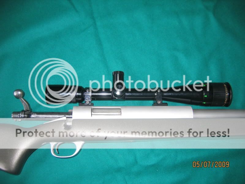

Hi, I just got 6mm ppc rifle. It is heavy barrel 26' with 1-14 twist
Here some pictures of my rifle:
The trigger is around 1lb. Just touch it and it goes off.
I've got some ammo with the rifle. The neck is 0.261 in both fired and unfired rounds. I shot 9 rounds and only 6 rounds left :,
Shot cases are different :
1.454, 1.456. 1.45, 1.455, 1.452, 1.456, 1.49, 1.471, 1.462.
What is correct size of the shell or it is depend on the rifle?
Can i just take new 220 Russian brass, size with 6mm pps die, load it, shoot and trim to necessary size or it has to be sized with 6mm die and trimmed before shooting?
Do you use 220 Russian brasses to form 6mm cartridge?
What bullets, powder and primers do you use for 300m accuracy shootings? What is Cartridge Overall Length and length of the brass itself?
Sorry for so many questions, but I want to start right.
Please reply to j_m_ru@yahoo.com.
Thanks,
Joe
Read these........
http://www.benchrest.com/FAQ/
http://www.6mmbr.com/6PPC.html
Nice Sleeved Rem... If metal work competent and the barrel has min rounds... It'll shoot dots.
