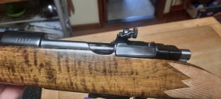

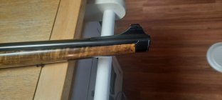

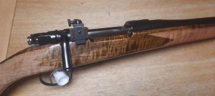

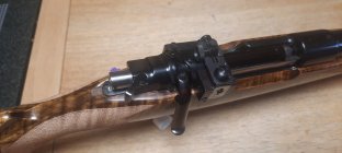

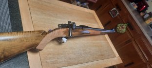

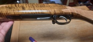

6.5 x55 swede very nice cartridge very underrated. I built a cz 24 curly maple full length stock butter knife bolt handle drill for scope and receiver sight blued steel grip cap inletted sling
Wish I know how to upload pic that was many years ago. The full length stock gun just seem to point well for me. The stock turned out well a buddy of mine done the checkering I have no patience for that.
