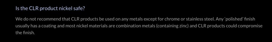

This is from the Safety data sheet for standard CLR:
Restrictions on Use: Incompatible with strong oxidizing agents, metals (except stainless steel, chrome), acids, bases, and bleach.
since there is over 20 different types of CLR and all have different chemical makeups Make sure which type you are using! What I see from your Pic, that brake was Plated (most likely nickel).

Thanks. I did not know they made different mixtures. I'm pretty sure, but not positive I am using the same as the video I saw. The brake isn't plated. It was turned down to match the diameter of the barrel and bead blasted.
