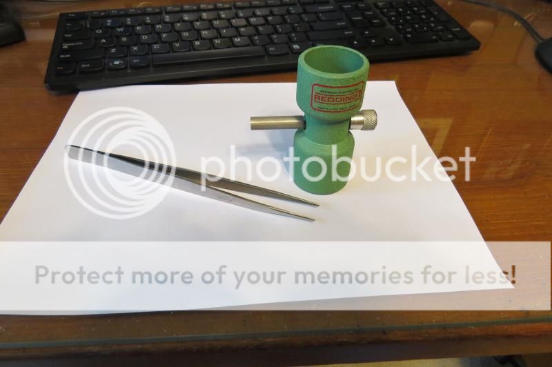

USE TWEEZERS.
My trusted and proven procedure is that I place the redding trickler on top of a small home made stand that has a slight tilt to it. (ie; it sits on a small block of wood cut at a slight angle) The inside of the Redding trickler tube is made with fine spiral lines machined into it, so that when you turn the tube very slowly these spirals will drop only a single grain at a time. If by chance I need a grain more or less in the pan, I simply revert to tweezers. I find using my fingers are too clumsy and not nearly as fast as using tweezers.
EDIT; I meant a single "Kernal" not grain.
+1 for tweezers. I have Redding trickler that only collects dust. I use a powder drop to get close, then tweezers to finish off. simple and fast.
