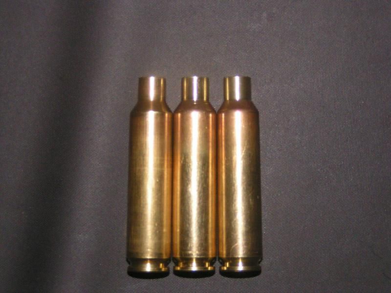

Right to left, necked up 6.5x284, hydraulically formed Shehane, 7 times fired Shehane.

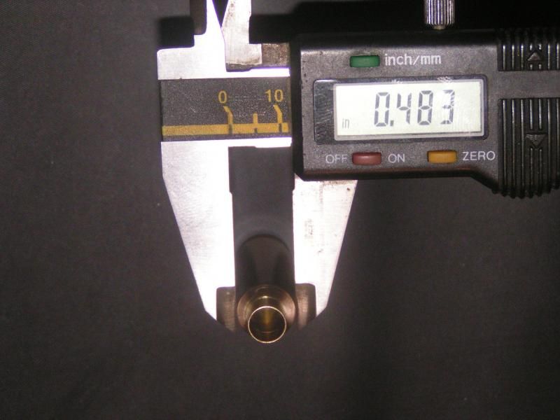

Measurement at the case wall shoulder junction of a 7 times fired Shehane case.

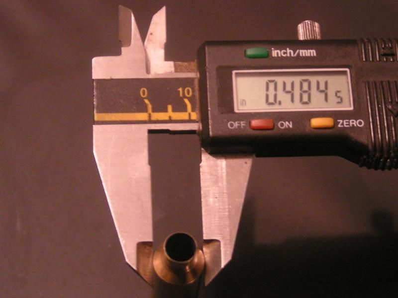

Measurement of the hydraulically formed Shehane case, it did actually measure 0.484 but it moved while taking the photo.
