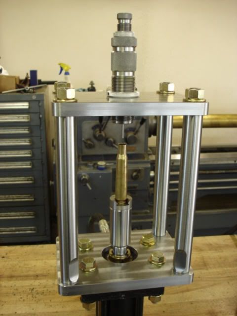

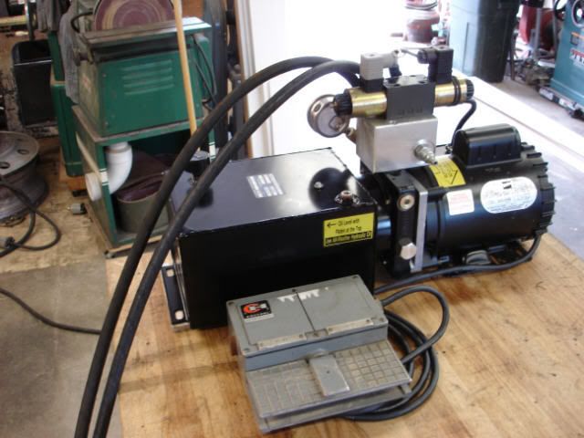

I had the bug to have a 50 BMG built and decided to build a reloading press for it. I used a hydraulic ram and a small electric power unit with a foot pedal to actuate it. I fabricated the rest of the press in my shop. It works really well, and I still have all my fingers.
Very nice work!
