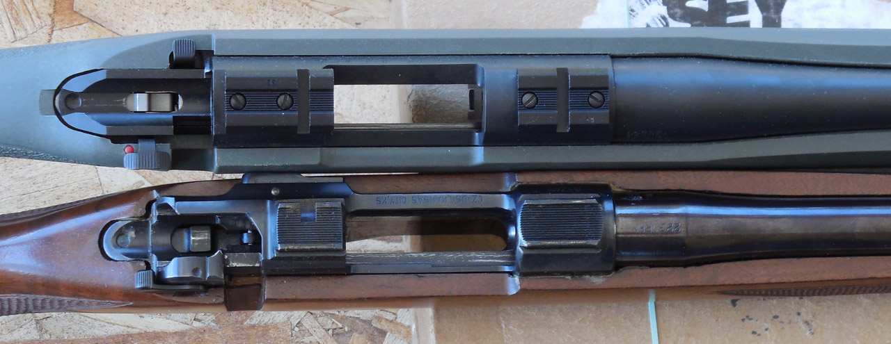

FWIW, the 527's narrower/lighter/shorter than the Mini which is narrower/lighter than the Remington Model 7. The Cooper Model 38 is the smallest by far, but only a single shot, expensive and discontinued.

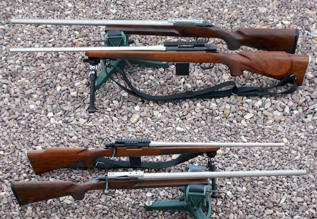

The Mini's out on loan. Otherwise foreground to background: L461, 527 and M7. I tried to line up the recevier rings at the barrel. The scopes kind of dominate the photo, but oh well. The mini's effectively the same size as the Sako, so you'll just have to use your imagination.

With regard to the Mini, in my opinion, it really is in a class of its own for current-production actions. The CZ is similar, but it's roughly twice the cost, and mechanically at the limit for Grendel sized case heads/pressure. There's more 'meat' for lugs to hold pressure in the Mini vs the 527. If you want to discuss weights, compared to a Remington Model 7 the Mini's nearly 5 oz lighter:
