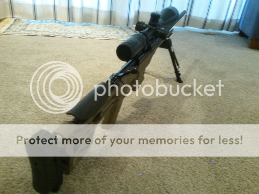

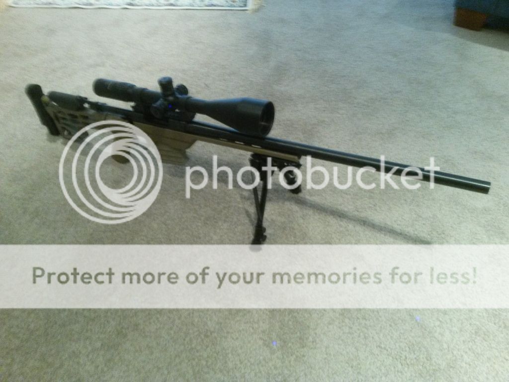

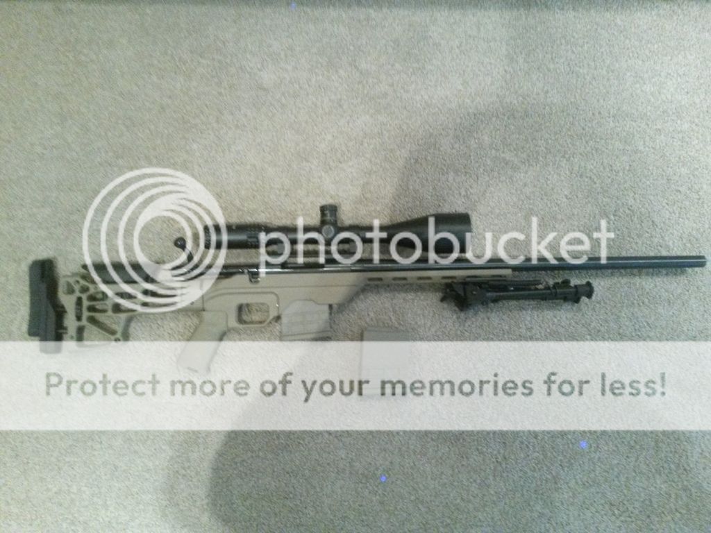

Well... Its finally all arrived! Very excited now. Problem is i'm moving about 1000 km so won't get a chance to shoot for a few weeks. At least Its ready to go though! Sorry about the crappy photos, Had to use my phone and its a bit old.
As for the chassis... its an MDT LSS-XL forend with their mark 2 stock. I'm still forming an opinion on it, but so far i'm impressed with a few features, but I was quite disapointed at the fit of the action. It fits firmly and tightly, but it really feels like its sitting on the stock, rather than in the stock. The cut in the forend for the barrel is off centres with the barrel by probaly 3/8"... it just looks and feels wrong. I have access to a weatherby vanguard so I'll try swapping that in to see if it fits any better (I feel it will be the same... I mean, they are built in the same factory on the same tooling). It does feed very nicely from the magazine though so that's a big bonus, and even with my crazy 60mm scope it doesn't look too rediculous on it.
One big problem (which is my own fault) is that the length of pull is too short. I ordered the MDT stock which they don't recommend for this forend (but there are pictures of the two together on their website... go figure). The length of pull is about 2" shorter than I'd like, and probably a good inch shorter than I'd really find acceptable. I'll machine up a spacer which will work to extend the stock. Its no problem and by no means a fault of the manufacturer but its frustrating. An added advantage is also that currently the cheekpiece blocks the bolt from coming out without removing the stock (one bolt, not too bad). I could cut 1/2" off the cheekpiece, but with the spacer in place it won't be an issue anymore. Time to hit the tools!
I'll do a more detailed review once I get to the range and shoot this bad boy, but for now, here's a few pics:

The rifle I used for the barreled action was about 2" longer than the MDT stock on the LSS-XL. It was a standard Hogue stock. I'm 6'2. I can shoot this prone pretty easily but it would be uncomfortable shouldered. I still haven't shot it yet (soon I hope) so will post a range report then and can give you more info. All I can say at the moment about it is that it feeds really nicely.
The main disadvantage of the MDT skeleton stock (on a howa at least) is that the stock needs to be removed to put the bolt in and out. I store my rifles with the bolt out so its a big pain to have to remove it. I saw that there are 1" spacers available from DPMS but getting one sent to Australia is verging on impossible or stupidly expensive. As for the adjustable buttplate and cheekpiece, they are great (except the butt plate is now set to its maximum length... Hopefully I can fix this soon though so I can actually have the adjustable bit in a useful range)

The stock is quite well made. I did notice some machine marks that were a little off from where they re mounted it in the machining process, but nothing that would effect function. Magazines locked in firmly with minimal play, including both plastic MDT mags and aftermarket steel mags. The butt bolted to the for-end with no rattle and it was a positive lock. The adjustable cheek-piece has a little rattle side to side, but I do like the adjustability of it. There is a screw to lock it in place and stop the rattle but it does then require an Allen key to adjust. It would be OK if you only shot from one position, but it defeats the purpose if you're shooting from multiple positions.
The action fits firmly in the stock, although I was a little disapointed as it really did look to me as though the action was sitting on top of the stock, rather than in the stock. You can see the point at which the polished surface of the howa action gives rise to the forged surface at the bottom of the action - something that you couldn't see on the factory howa stock. I'm sure its different for different brands.

I got the 24" varmint barrel. One thing I can say is that this package, with the Skeleton butt piece is a heavy package. If you want anything other than a range rifle, I'd recommend a fluted barrel and a lightweight stock for it.
