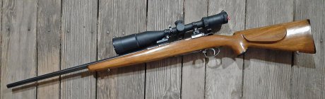

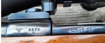

Other donor gun is a Mauser 98, which was sporterized and made into a 22-250. Nice stock, but has full glass bedding down the barrel, old school style. The Mauser shoots pretty well as a 22-250, but not as good as the Howa, however with maybe free-floating the barrel, it might shoot better. It's got the old style safely, which is unusable with a scope, but it's a beautiful gun, for what it is. The bolt is kinda clunky and not smooth to run.
