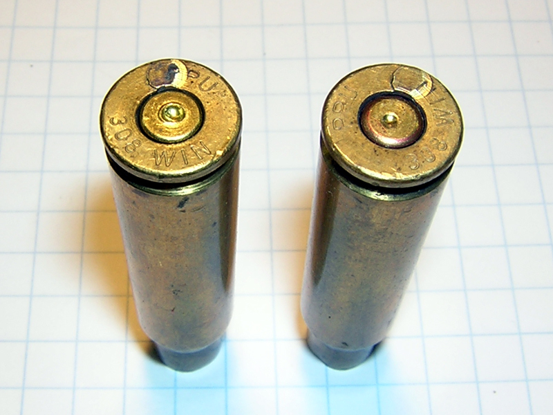

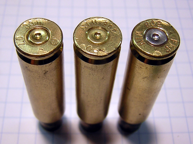

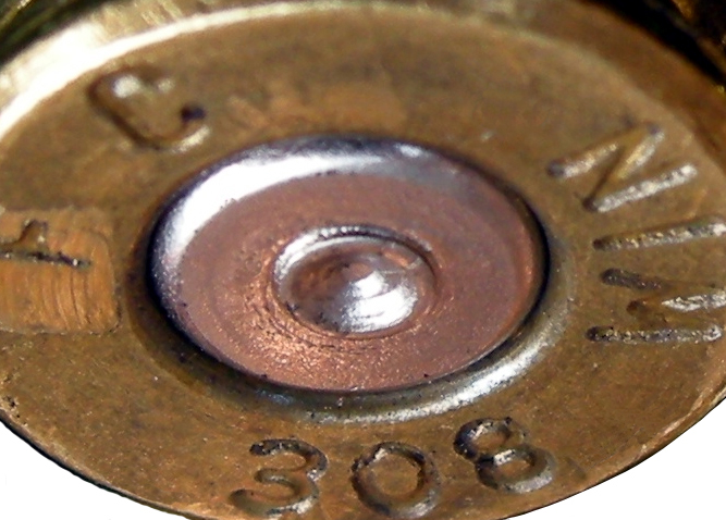

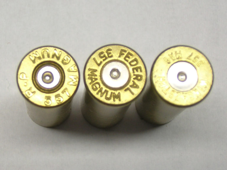

Here's a good series of pictures of a flattened primer.
An extruded primer

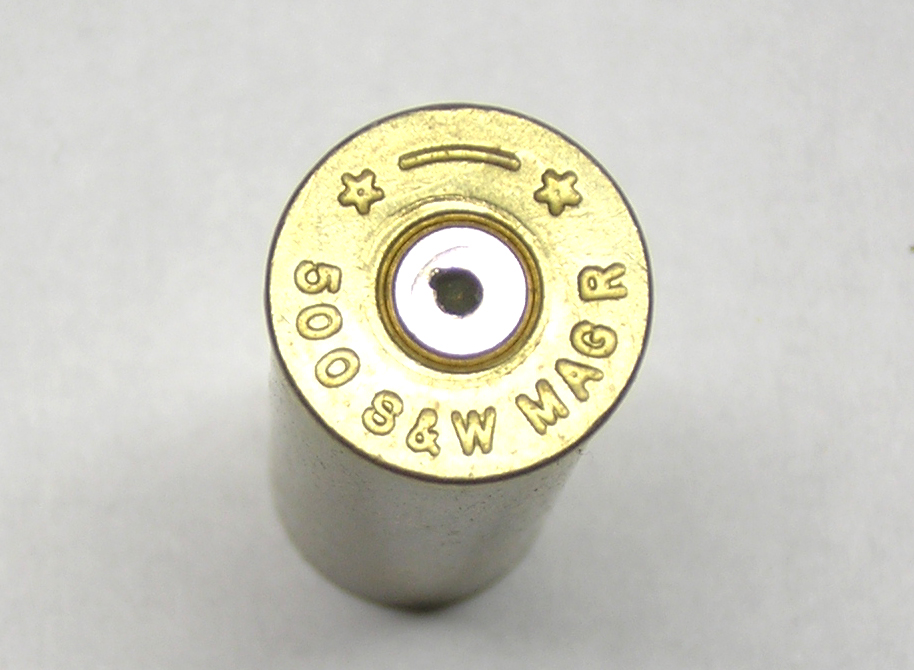

Pierced primer
Extractor marks
Bent rims and deep extractor marks

357 magnums when fired in a S&W revolver will have an extremely flattened look because of the convex bushing around the firing pin hole.
The extruded primer is just a firing pin fitting loosely.
The 500 S&W mag could be from two causes. A problem with the shape, condition, or protrusion of the firing pin. The use of a pistol primer when the S&W 500 mag should have a rifle primer.
The ejector marks are often from high pressure but sone guns will make ejector marks at normal loadings, although those look pretty pronounced. Maybe the ejector is proud of the bolt face for some reason.
The bent rims and extractor marks are more involved than I can go into here.
