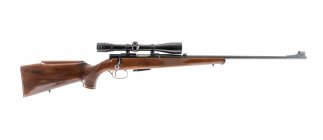

Here is a good picture of what I have going on. The original design is intended to be a sporter (First picture).You can see how the taper matches the angle of the magazine.
Are you saying that you set yours up to look more like the example (second one down) in this picture? My magazine is buried a little further than this.
