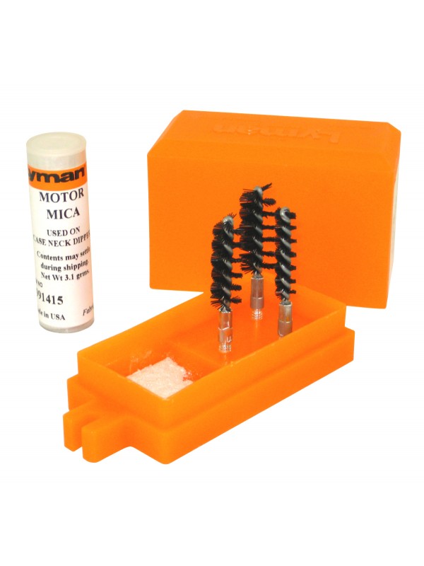

I use this little thing from Lyman, been working fine for me for years.
I sort of grip the brush just under the bristles so the neck stops against my finger
