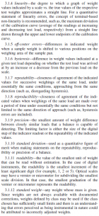

Linearity is the error between the zero and cal points not attributed to calibration error, zero error, or repeatability.
Cal at 10, 20 and 50 grams on a 100 gram scale and the max linearity error would "probably" be right in the middle of two adjacent cal points. Powder charges of 2 or 3 grams are close to zero on a 100 gram scale.
Linearity error is what you would expect by calibrating @ 50 grams and weighting 10, 20, 30 grams.
With 0.02 readability digital roll over could indicate 29.98 grains with 29.97 grains on the pan.
29.99 grains in the pan could also indicate 29.98 grains. That's with NO actual scale error.
Just a feature of digital devices. One half of the least indicated interval, +/-
Note that this rollover applies to a zero, a weighed value and the closest calibration point.
