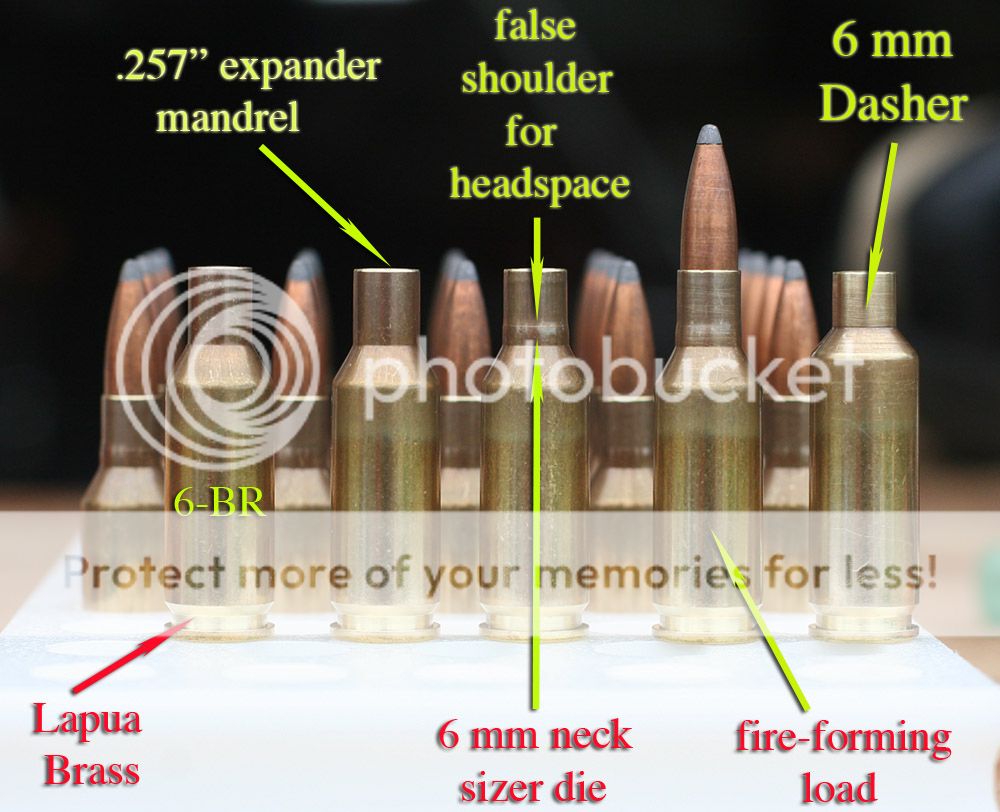

Here's a photo I posted a few years ago, showing the slight false shoulder.
Because that's what I have....thanks for the great photo...very helpful.
