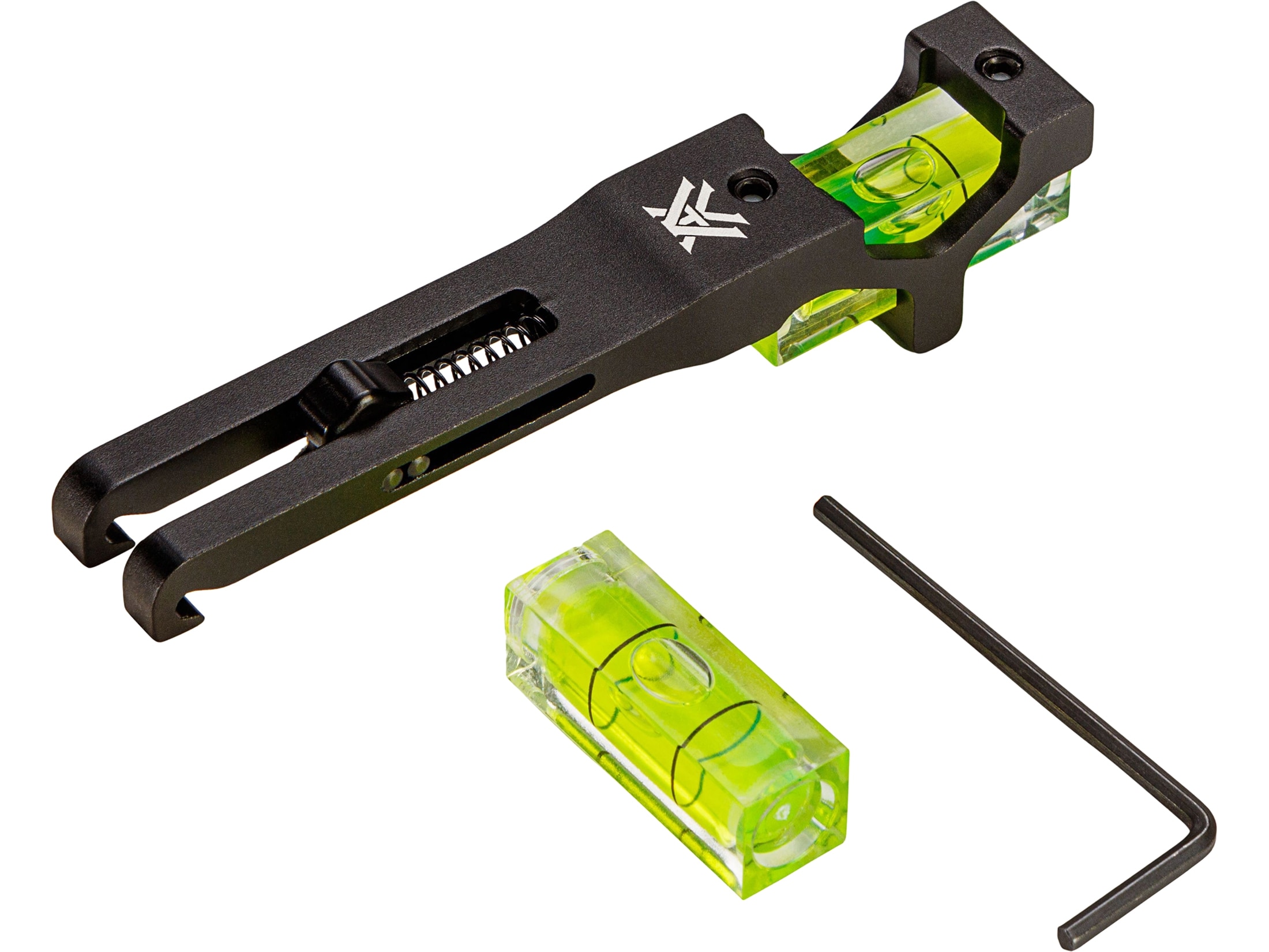

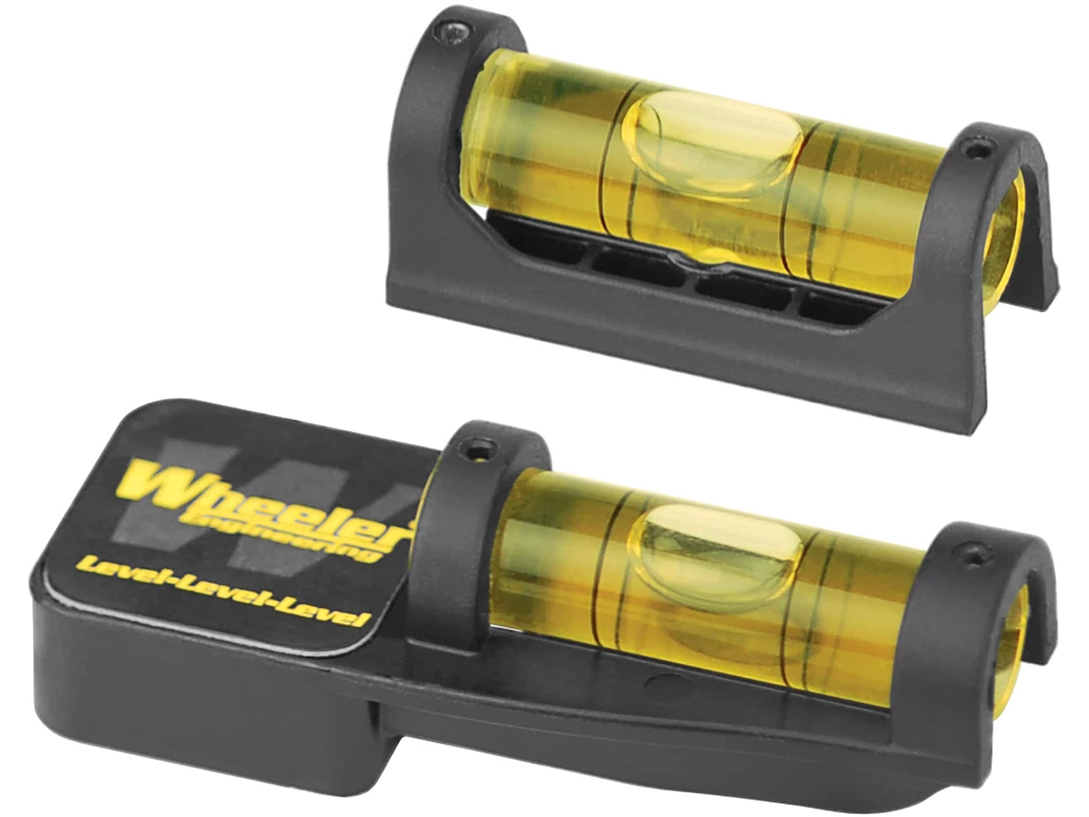

I have use this bit of kit and had good results, an easy button over hanging plumb bobs or other more elaborate procedures.
All suggested ways will work but for me this just makes life easy and I keep it in my range locker to assist others that come in to start their shooting career with their new rifle and scope.
Where u get that?
You can them from midway or most any site sponsor here. I have all these in accumulated over the years. Use them all.
