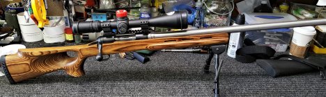

Well I took the .223 Prairie Dog gun out to the range today to see if there is still any "life" left in the barrel. It currently has close to 11,000 rounds fired. It has been in service for 11 years of Prairie Dog hunts plus general range time.
Well I think I answered the question.
It continues to amaze me with its longevity..
5 rounds fired at 500 yards: 1.38" group (.26 MOA)
.223 McGowen heavy barrel
53gr V-Max bullet with a muzzle velocity of 3,150 fps
NightForce NXS scope.
This barrel, when retired, will be replaced with an URB barrel!
Nice....is there any rifling for the first few inches?
I rechambered a PD Savage 223 that had 10K+ rounds on it. There was no rifling for about 3-4 inches. It still shot MOA from the bench.

I am truly amazed at the accuracy of that rifle with that many rounds down the bore.
I would continue to use it but have a back up rifle just in case it goes sideways during a hunt. When my 22 250 when sideways, it happened fairly suddenly, i.e. from about 1/2 moa to about 1 1/2 moa. Granted, the 22 250 is significantly over bored cartridge and that may have had something to do with its sudden drop off.

What Jeff said! The last thing that influences the bullet is the last few inches of the barrel and the crown. But the rest of the barrel needs to be smooth enough not to damage the bullet till it gets to the muzzle. Had a barrel on a 25-06 that had 3 rust pits a few inches from the muzzle. It never shot well after they appeared and I assume they were acting like a file and damaging the bullet.
