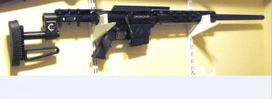

I have a brand new unfired 6CM (Comp Match) that is waiting for me to find time to play. Since it was built around a black Pierce action it will make an excellent test case. I will contact MMI and get instructions on how to proceed.

Joe, that is a sweet looking rifle, you will be pleased with the 6CM.
