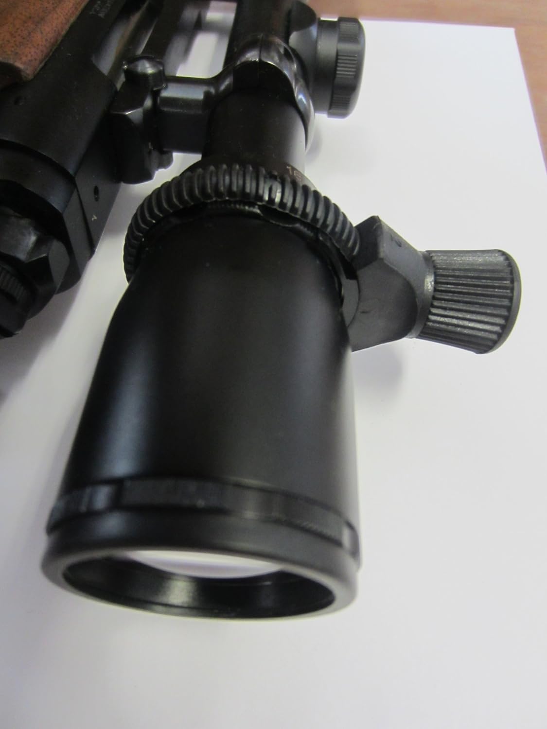

Are you talking about these?
https://www.amazon.com/dp/B00AAIRRTY/?tag=accuratescom-20
YES. Above picture is what i bought. Just did not work for me. 2 came in package from Amazon last week for my Vortex crossfire II scope. Neighbor kid and I could not make them work. ha ha ha. I think they are a little to smart for us , I do know both of us were not really strong enough to get them on tight enough to make them work. ha ha .
I think I paid 18.00 with postage of of Amazon. I would take 10.00 for both of them and pay postage. some one might have better luck. Marty
Really? They are not hard to put on at all. I have 3 on scopes. You just slide them over the power ring and tighten the knob. The excess comes out the top as you tighten and then you cut it off and done. No more tightening strength needed then putting the cap back on a soda and even if you did need more a pair of pliers would make short work of it. I am sure someone will buy them for $10 though.
Yep. I nor neigbor kid could not get them tight. Just did not work for me. Still have package they came in. Did not even attempt to try the 2nd one. Marty
