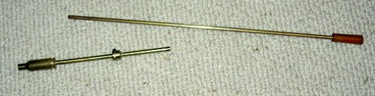

How do you fellas find the lands without a modified case?
Making your own gauge is pretty easy. A length of brass rod matched up with a length of brass tubing soldered to the base of a drilled out case with a stop fashioned onto the tube and you've got a homemade OAL gauge like the one shown here. I made it in less than an hour.
If you want to get a better picture of where the lands contact the ogive, use a little Prussian Blue on the bullet before seating it in the chamber.

I have the Hornady and I bought a tap and a drill and make my own.
I think it is a 5/16-56 tap. It's a special. I had to order it.
Ben
Ben,
It's a 5/16X36 tpi tap that you have.

I am wondering the best practice to go about finding my seating depth/jam/jump length in a 6AI. I have a modified case for 6mm but they do not make one for a 6mm AI. What method would you recommend to find the length to the lands with a particular bullet?
Thanks,
Chris
Modified cases can be purchases from Hornady, or the reloader/shooter can make modified cases by simply drilling the flash hole/primer pocket to a diameter that will accommodate a cleaning rod. After drilling the flash hole/primer pocket seat a bullet, the seating depth is of little concern as long as it is not too long, then remove the bolt and chamber the modified case with the bullet in the chamber, After chambering the modified case use a cleaning rod to push the bullet out until it stops at the lands, after the bullet contacts the lands the modified case become a transfer.
I use the transfer to transfer to the dimensions of the chamber to the seating die, all that is required of the reloader is a good understanding of the seating stem above the seater die is to be zero off the lands with a height gage or dial caliber. after zeroing the protruding stem, the height gage can be used to seat the bullet ‘off the lands’, remembering if the case was not fired in the chamber the difference in length between the chamber and case from the shoulder back to the head of the case and back to the bolt face should be added.
I have never been concerned with modified cases they did not make/sell, they do not sell modified cases for long chamber, they do not sell short modified cases, they only sell modified cases, I want my cases to match my chambers.
When I set up to drill cases for modified cases I drill the flash hole/primer pocket on at least 20 cases, and bullet hold, I am the fan of bullet hold, I want all the bullet hold I can get, others use a cut neck case to lesson bullet hold. On occasion when the bolt is closed on the shredded neck cases, the bullet stays in the lands, again, I want all the bullet hold I can get.

EASY, SIMPLE, nothing to buy, no drilling or tapping.
1. Make a dummy round by seating a bullet in one of your cases that you know will be too long and will touch the lands.
2. Remove the bolt from rifle and insert the dummy gently until it stops in the chamber. The bullet will be contacting the lands.
3. From the muzzle, carefully insert a cleaning rod into the barrel. With one finger, push lightly against the base of the dummy round, while with your other hand, using only your index finger and thumb, gently move the cleaning rod down the bore until it contacts the bullet.
4. Once the cleaning rod has made contact with the bullet, push a little more and you will feel the bullet disengage from the lands. You will be able to feel this contact between your two hands. Move them both in the same direction and learn to feel the bullet engagement against the lands.
5. Leave the cleaning rod in the barrel. Remove the dummy round from the chamber. Return to your reloading press and seat the bullet slightly deeper into the case, thus reducing the overall length. I reduce the length by .005 increments.
6. Return to the rifle and repeat steps 4 & 5 until the bullet no longer contacts the lands. Using .005 increments, you know the bullet is .001 to .005 off the lands.
Hope this helps. Practice a little and you'll will be amazed at the feel you develop for the contact of the bullet. If you don't believe what your feeling, mark the bullet with a felt tip marker. If there's contact you'll see it on the bullet.
