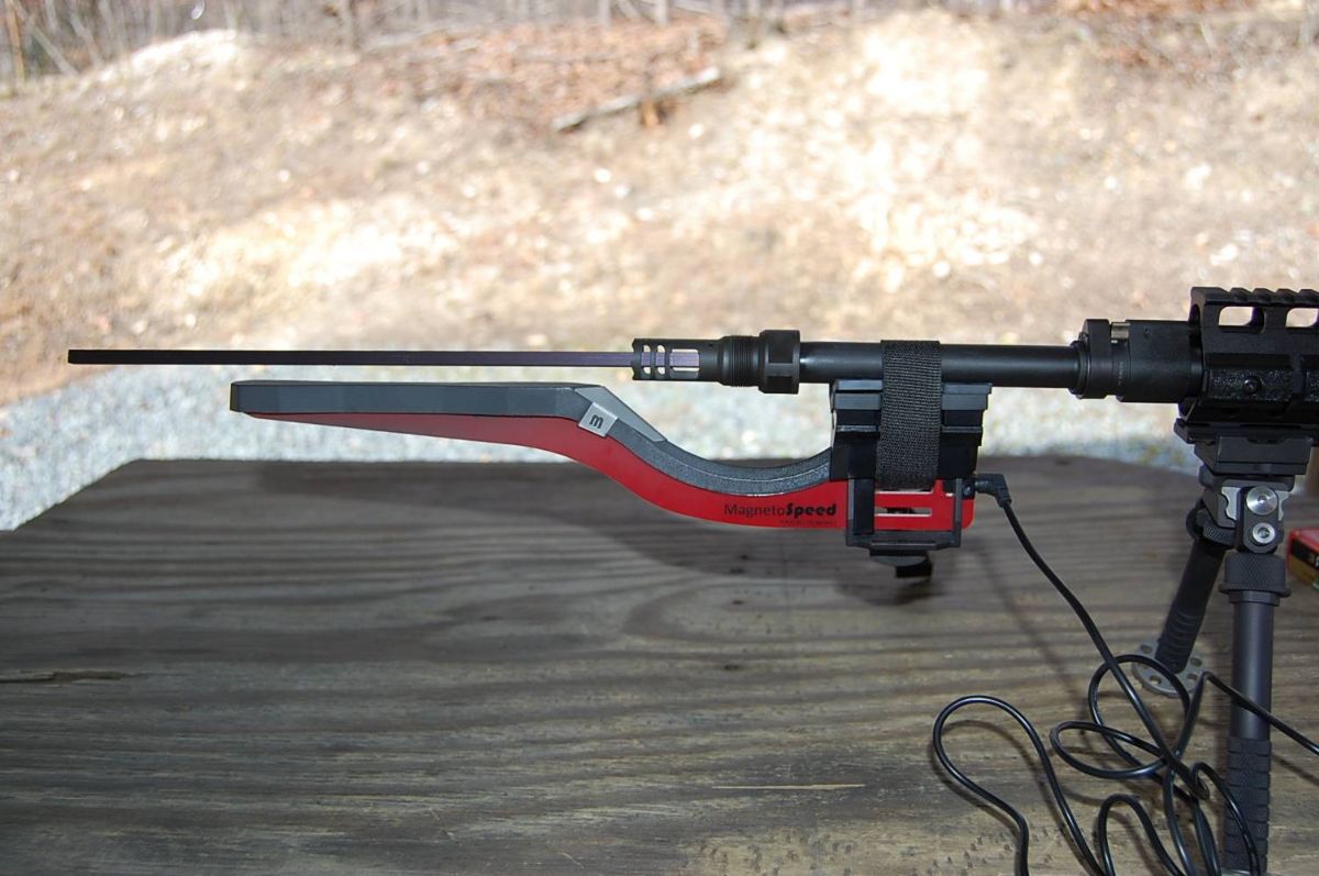

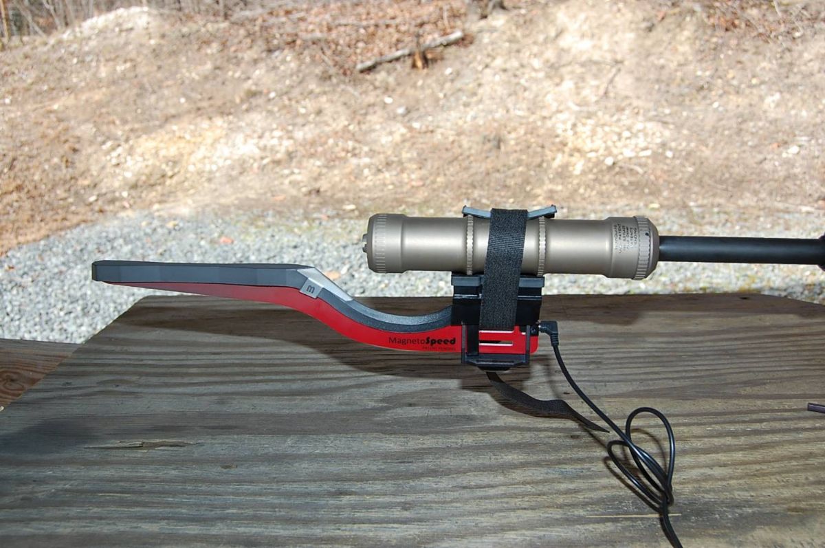

Only argument against the Magneto V3 is the barrel contact attachment & how it may, or may not affect group size...
To that end, I ordered one of these, from MK machining:
It allows a V3 to be mounted to a picatinny rail on the stock, and is adjustable enough to get the V3 where it needs to be. Viola, the only potential downside of the V3 has been negated!
I got this specifically to try during load development of my .220REDLINE. Being its a pretty nasty hotrod, I'll be able to collect both accuracy & MV data from the same ladder test and save some barrel life...

One drawback is that I find that it changes the POI. Sometimes tuning or de-tuning the barrel in the process as it moves forward during successive shots.

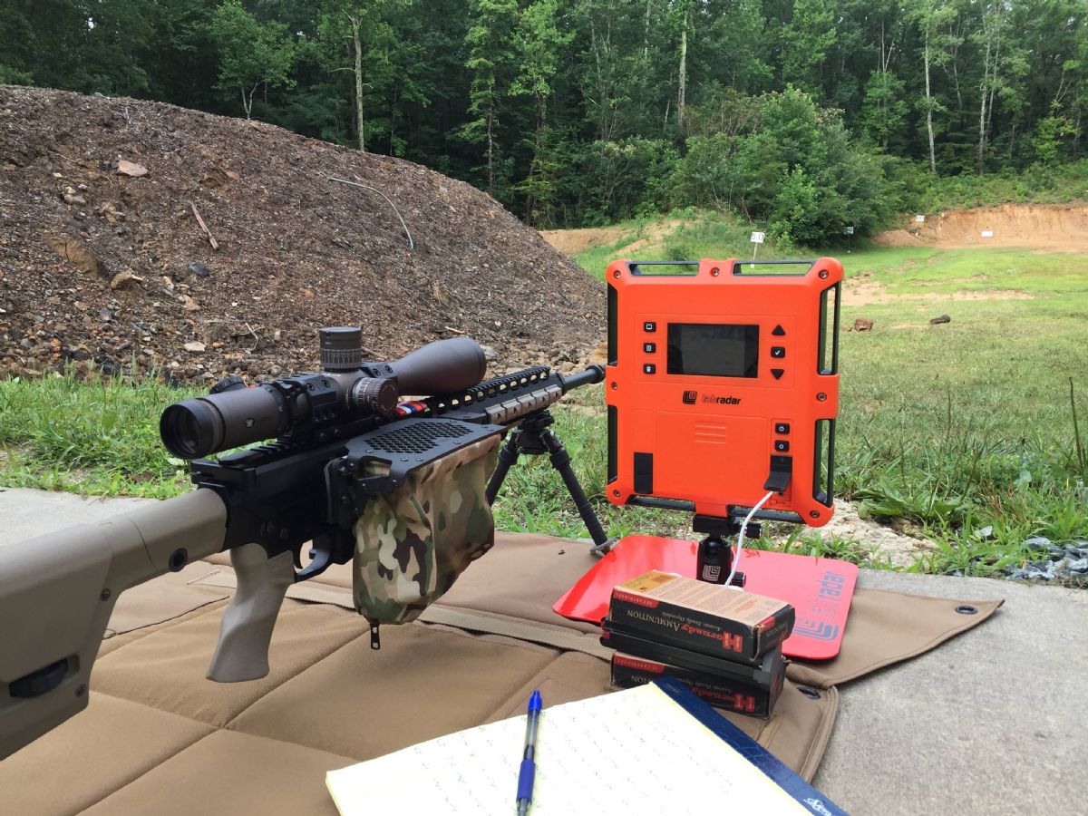

There have been some (enough) comments about the labradar finicky nature. How is their customer support? I could put up with finicky as long as it is accurate and reliable.
The advantages that I see are that I could quickly shoot different rifles back to back and get data (for instance my on a 5.56 get data on the same load for 16", 20" and 22" barrels. Another advantage is the ability to get downrange velocity data and be able to verify BC.

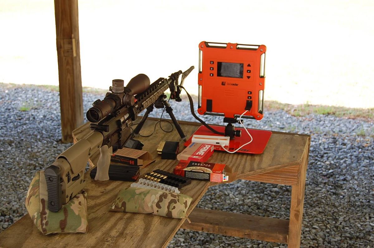

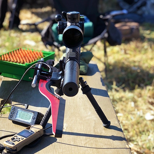

Each has its quirks. The V3 is finicky about the gap from the bayonet's magnets to your bore and the strap is a pain. The LR is finicky on placement relative to the muzzle so it picks up the shot and remembering to arm it to capture the string. Playing with each for a bit solves either issue. I have both and after getting the LR, the V3 is sitting in the cabinet.

Got my Labradar about a year ago.when they were relatively new. When i had a tech question i would contact the company and the DESIGNER /Owner of the company answered the phone to address my questions. You cannot get better than that !
DEFENDER 3::: Cut a new hole in the Baseplate about 2 inches from the front and in the center.This will allow you to move the unit closer to the edge of the bench and will give you easier set up. Use an old rear bag, or sandbag as a counter weight.

How do you know at what point in front of the muzzle that the LR is first picking up the bullet?
In a previous post i stated that the Unit functions better if moved further out on the bench. It is triggered by Muzzle blast and there is a Set of Velocity's. It doesn't just read the first few feet like a traditional chronograph. Here's an example
Series :0001 Shot 001 FPS YD
VO= 1051 ( At the Muzzle)
V 10 997 / V 32 932 / V 54 863
V 21 964 / V 43 898 / V 65 810
The V-10 is at 10 Yards, V-21 is at 21 Yards etc
I hope this helps you to better understand the function of the unit
