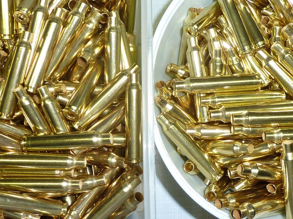

I guess I am another one that is very pleased with Hornady brass. I only have used it in 204 Ruger and 223. Most of what I shot was factory loaded Superformance since I could get them for almost the cost of new unprimed brass. Didn't lose a single round in the initial firing for over 1,000 rounds. Primer pockets are nice and tight and weight variance was about the same as Win or Rem. The sizing was Ok on mine, definitely not short, case head to shoulder datum, like some brass.
It was much better than the recent Win 204 Ruger brass I bought where I had to return over 15% due to the shoulders not being properly formed. On these the case head to shoulder datum measurement was over 0.010" short and the shoulder didn't properly form on the first firing with a normal pressure load. The picture below shows this issue with the brass on the left side being the problem. The color was quite different from the acceptable brass like it was a slightly different alloy.
