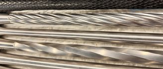

@boltfluter - what style do you call the tight twisted one on the right?
He calls that style Tac. I’m guessing it’s 6 flutes so if I’m right on the count it would be a Tac 6. The other is his Vortex.

Some examples he’s done for me:
Tac 8 top, Vortex bottom. Not long ago this Tac was considered an aggressive twist :D
Vortex 6 bolt.

If any type of accuracy is involved, wouldn’t it be best to do all of that extreme fluting and then have the blank drilled, reamed, and rifled?

On a good hunting rifle I have not seen a negative change as far as Paul's fluting goes. I did one not long ago that had previously been chambered and shot a fair amount so I knew what it could do. Fast forward after doing some aggressive Vortex fluting and adding a supressor it shoots as well or maybe better than ever. Hardly even a POI change. Now would I do it on any sort of BR rifle? Probably not.

For a quality stress relieved cut rifled barrel, not really. I've turned down a half dozen HV barrels to M40 profile, cutting their weight almost in half, and they still shoot like new.
