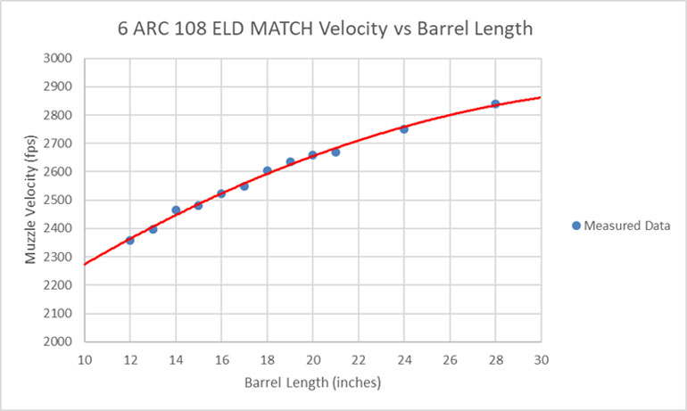

OK. But why is Hornady advertising 2750fps?
They not only used 24" barrels for testing, from what I can glean from news releases and reports the first rifles to be delivered will be used in a specialized roll and will have longer barrels.

They can also use proprietary powder blends that reloaders don't have access to, to optimize the pressure curve and get more speed.
Correct, also Hornady and the powder manufacture have the facilities to test pressure and velocities in the standardized barrel in real time. Formulating each new lot of powder to present the optimum pressure curve. After reading how military ammo manufacturers produce their product I came to realize that to them the curve is everything and powder charge weights can and do vary tremendously between ammo lots.

People are already loading for this and getting the stated velocities without issue. I'm just waiting on a few barrels to come in before I'm doing the same. I'll certainly report back once I can.
