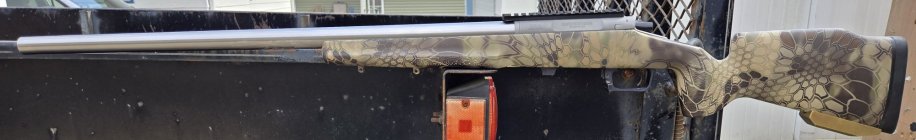

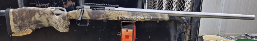

Keep comments coming please. Just built a 25-6.5 PRC and will be breaking the barrel in very soon. 131SMK, 134 ELDM and 138 Atips to start. Starting with Retumbo but will likely be changing to N570. 27" tube.
Having other boring life issues that are putting me a bit behind but getting closer. Put glass on Monday and have break in loads with 131s ready to go. Will see what happens but with retumbo it looks like I will run out of case about the time I run into pressure... I suspect N570 to be the same. Short action.

That’s some serious speed! My 25/284 topped out around 3020 with 133/135s. Lapua brass rl-26,h1000, h4831sc all max just above 3000fps in a 24” barrel.
Yes I was shocked. So many had 3100 max so I was expecting 3000-3100. To my surprise the 3198-3220 was just unbelievable and those velocities were in the first 30 shots. Did some break in shooting then zeroed the scope. Load data came next and at the upper RL26 loads showed 3200+ with great accuracy. I will say that 3200 was not the best accuracy and I didn't want to step on it that hard anyway so plans were around 3000-3050 for the best of everything if I could find a sweet spot. I did.
