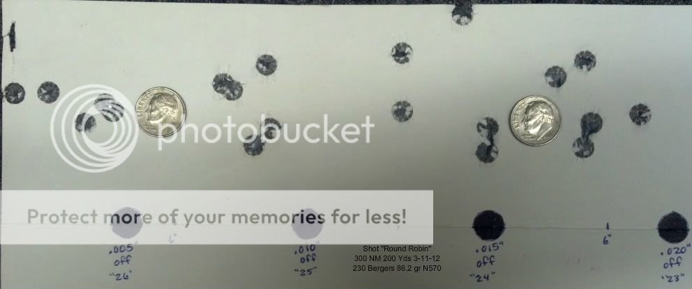

I went out at 200 yards to test some loads and see what would happen with seating depth changes. The first picture was shot "round robin". I would shoot one round that was 0.005" off the lands and then progress until I had shot all 4 loads ending at 0.020". I adheared to a 2 minute shot interval. The next round was shot from right to left etc...
Between the 5 total shot stings, I would shoot groups with the 260 (which we'll get in to next). Here's the results with the first rifle.
The issue I have is the horizontal stringing in the first group shown which is 0.005" off the lands. Vertical C-C is less than 0.45" Horizontal is 1.3". All the other groups look "similar" although terrible.

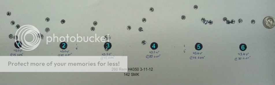

My 260 has 2 group that show similar results on groups #5 & 6. The groups were shot left to right, 5 shots at a time with ~10 seconds between shots. I varied charge weight and OAL on these groups but when the vertical went away, the horizontal gets excessive.
Vertical on #6 (C-C) is ~0.16", Horizontal (C-C) ~1.6".

The reason I don't think it's wind related is the different way both targets were shot. The top target was shot round robin. Total time to shoot all the hole in the top target was ~ 2 hours. I started with the left dot, shot right and then I went and shot the other rifle. When I came back to the top target, I started on the right dot and then shot left. When that string was done, I shot the other rifle, etc, etc. If it were wind, all the groups should have shown the same stringing. I made an initial correction of 0.1 mil left because there was a 8-10mph L-R wind blowing when I was standing. I NEVER MADE ANOTHER ADJUSTMENT so, the wind should have been a constant in all the targets.
The second target was shot in 5 shot groups. I started with the left dot and shot all 5 of those particular rounds. I would shoot 2 5 shot groups and then pick up the first rifle again. The first four targets have more vertical than horizontal. It's the final combination in groups 5&6 that drops the vertical and picks up the horizontial.

What I'm getting at here is that both targets (sheet 1 and sheet 2) have targets with horizontal stringing. Since the top target was shot "round robin" and shows a horizontal group and the bottom target was shot as "5 shot groups" and has 2 different groups showing the same stringing. What is the cause?
