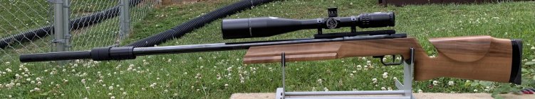

When i shoot my Annie, it likes a light grip and the buttplate just touching the shoulder with no pressure.. when you break the shot.. the only thing that moves is the finger, you have to remain completely still.. shooting off a SEB Mini with a Rodzilla top and a Protektor rear bag. Anschutz BR Stock.JPG
