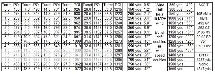

I used to do a 200 yard zero, MrM. But I've switched to target turrets on my scopes and now I have a 100 yard zero and dial every shot. Now I can put the crossshairs on center mass and my kill ratio has gone up.
i am a firm believer in using a ballistic table for targeting ghogs, esp at long range. many years ago i was taught to zero at 100 yds and "hole over" on ghogs beyond that zero. this was fine out to say 250 yds. then one day i guessed the elevation for one at 300+yds and missed TWICE...both low. i just could not make myself hold the crosshair that hight in the sky! i watched a special on tv about sniper school and watched as the shooter's spotter told him to "click up 3 min" and it hit me! he knew how much elevation to put in the scope for the crosshair to be dead on the target! i looked up "ballistic table" info and have not looked back. the latest hornady site has a nice one that's easy to use. there are many much more complex ones and you now can do one in the field with current values...neat. my personal best is 532 yds and the leupold dot was exactly on the pigs chest and to my amazement, the bullet went exactly to the dot! DRT! i take the hornady data and translate it so that for every elevation click, i have a range. now, if i could only learn how to dope the wind.
Totally agree, LP. I create range cards but I do things a bit differently - my increments are in .5 MOA of scope turret settings instead of every 25 yards of range. The right side of the card (becomes the back side after folded) is for wind drift & other info. After the card is folded and laminated it fits nicely in a 50 round ammo box.
