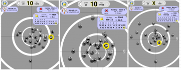

Gonna have to disagree that the CCI 450s are the issue. Here's the results of my last club match under less than ideal conditions. Raining and wind from every direction at the start and having to wipe the water off each case before firing. Relay 1 was virgin Lapua 6BR brass with a FF load using a messed up lot of H4350 with 2.8% N555. Relay 2 was my "usual" 6BRA load with N150 and 107 SMK - the low and high velocity shots (3 and 12) have identical elevation on target so getting some positive compensation there. Relay 3 was a test load with AR-Comp and 105 Hybrids. All 3 relays had an SD under 8 and all 3 shot with sorted CCI450s, 3 different powders, 2 different bullets and 3 different velocity ranges.
