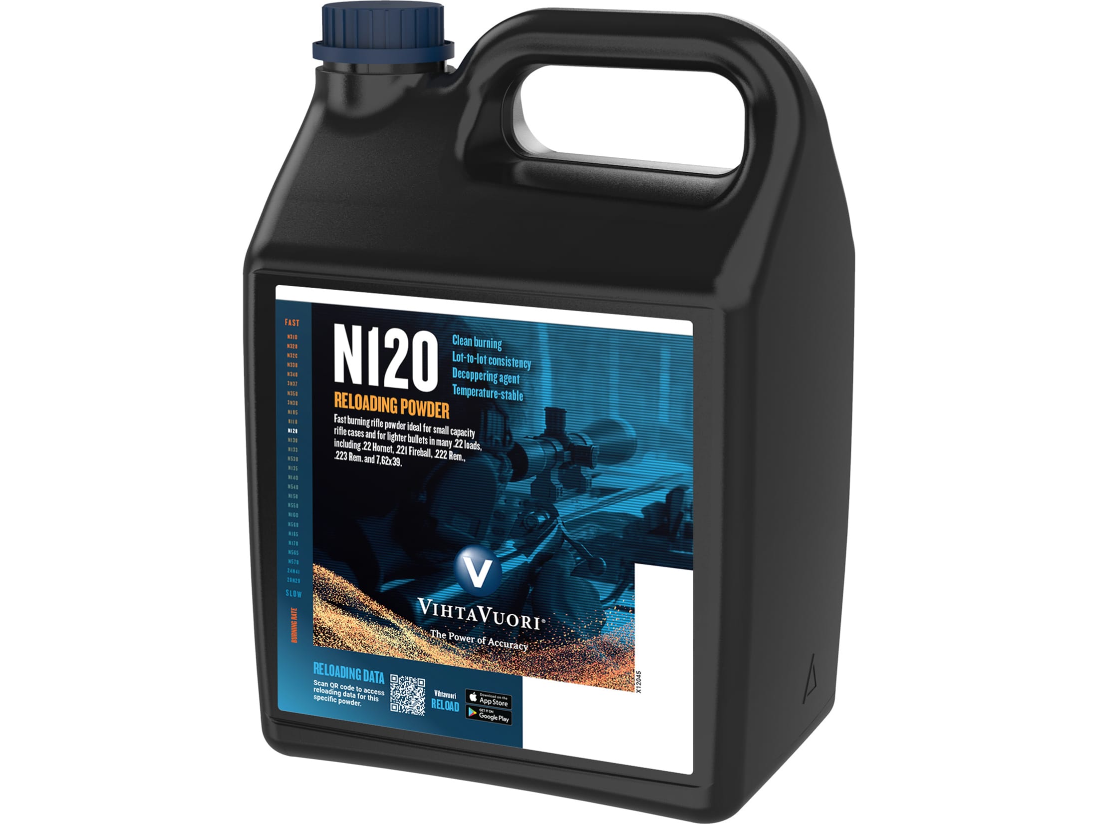

I have found that the 8 pound jugs or N120 can actually be less expensive than comparable domestic powders, which is surprising.
$289 on Midway, in stock too!
$205 here, don't know if it's legit?
$285 Graf & Son, in stock right now.

Good prices but I need a pound to try. I did buy one and it should be here next week, hopefully.
