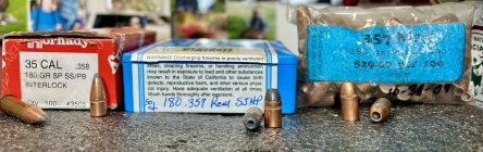

I loaded the 180 gr Nosler .357 Partition, back when they were still made, out of a 10” T/C Contender octagon bbl. Also worked with the Hornady 180 gr. SS/PB (Single Shot/Pistol Bullet), but it was really designed for .35 Rem out of the T/Cs; little to no expansion at the velocity capable in the .357 10”.
The Remington 180 gr SJHP was a pleasant surprise, due in part to its well exposed lead hollow point and thinner jacket. Expansion was good as was accuracy.
