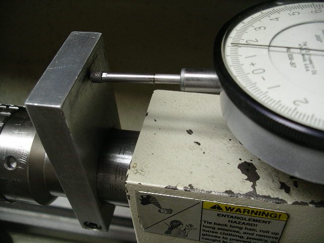

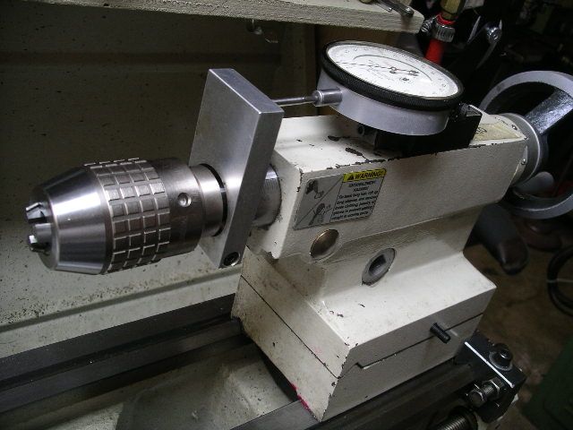

RGC54's and Gene Poole's method is what I use but with a .0001 travel indicator. .002 is a country mile. I remove the travel indicator when not needed.
Tac284's picture of the travel dial on the ways to show precise location of the tail stock makes for very, very accurate re sets for chip clean out.
