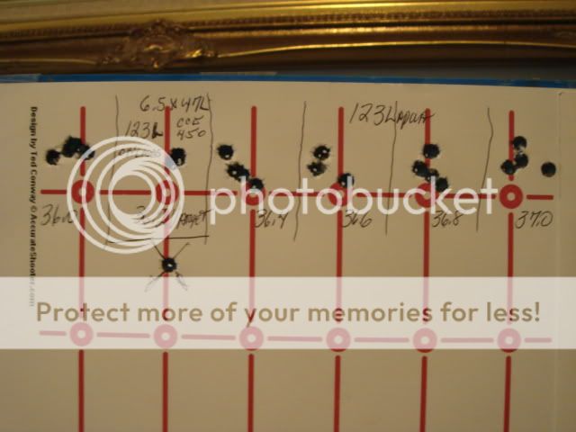

Sometimes a picture will speak louder than words!
Well, below is a picture with "120 smk's" and RL15 . . . FYI
28" McGowen 8 twist heavy barrel, Savage action. Deadly accurate at 100 yds and 600yds as well.
I have some 123 SMK's, I am getting ready to load, just might try a few of these!
Also, I tried some 123 Lapua's, see picture below! Amazing what a couple of grains will do to a group!

Second pic I was doing a ladder test to find the right load! I was using a bi-pod when shooting.
