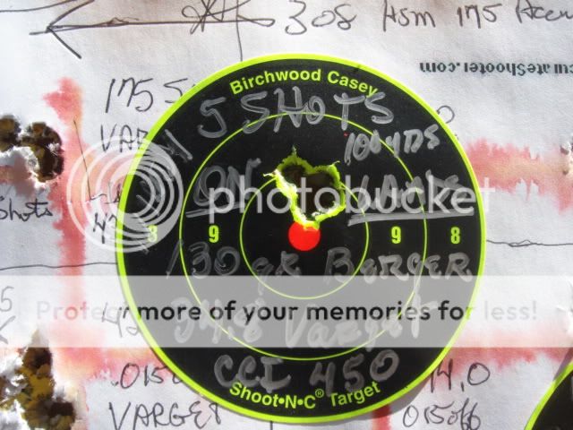

I have a 6.5x47L with a 22" barrel. I'm getting very good results at 2770fps or so with 130gr Bergers jammed 0.010", 41.5gr H4350, and Wolf SRM.
Same load of RL17 got me 2935fps, but the accuracy wasn't there.
I can get in the 2700 range with 35.0grns of Varget and produce a great group!

Below is with 34.8 grns Varget, I can produce the same with 35.0! 2,700 to 2,775 fps range.
