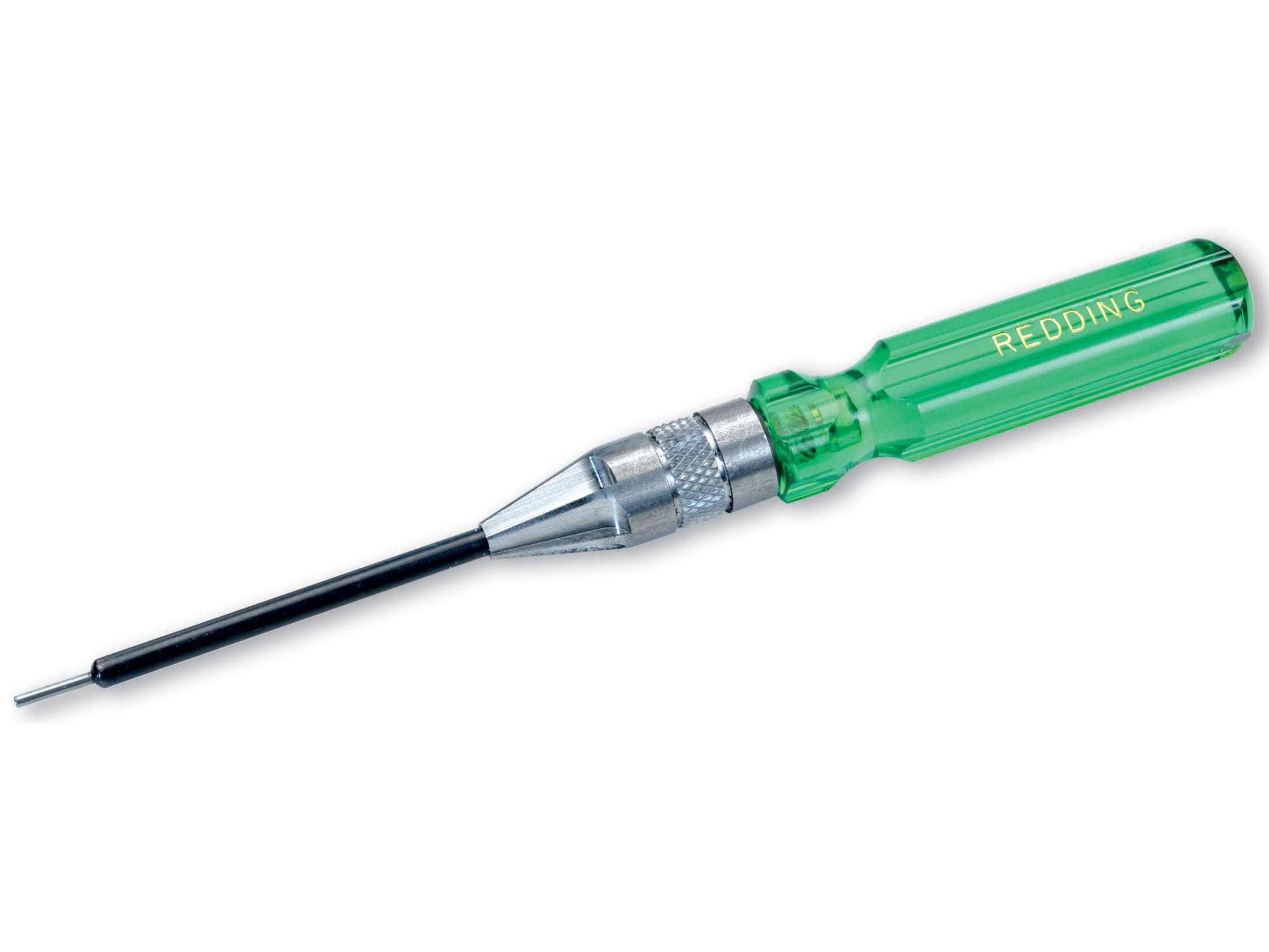

Have you ever tried this one?
It is more of a tapered reamer with a center and depth stop, it is generally a hand tool but it too can be powered. This is what I like to call the nuclear solution. If there is an ID chamfer issue, this should kill it.
All of the ones above should work no problem, but I thought I would point this out in the case where you hadn't seen it.

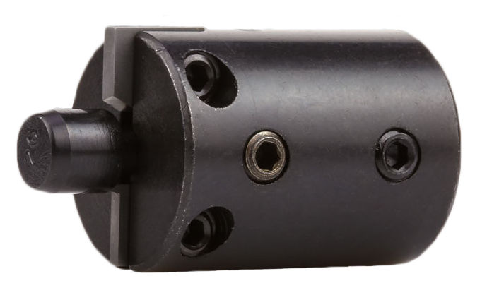

If you own a drill press, vertical mill, lathe, or anything that moves and stops precisely; mount a Forster or Henderson 3-in-1 tool in said machine, along with a Lee case holder held in a vise, and trim brass the easy way.

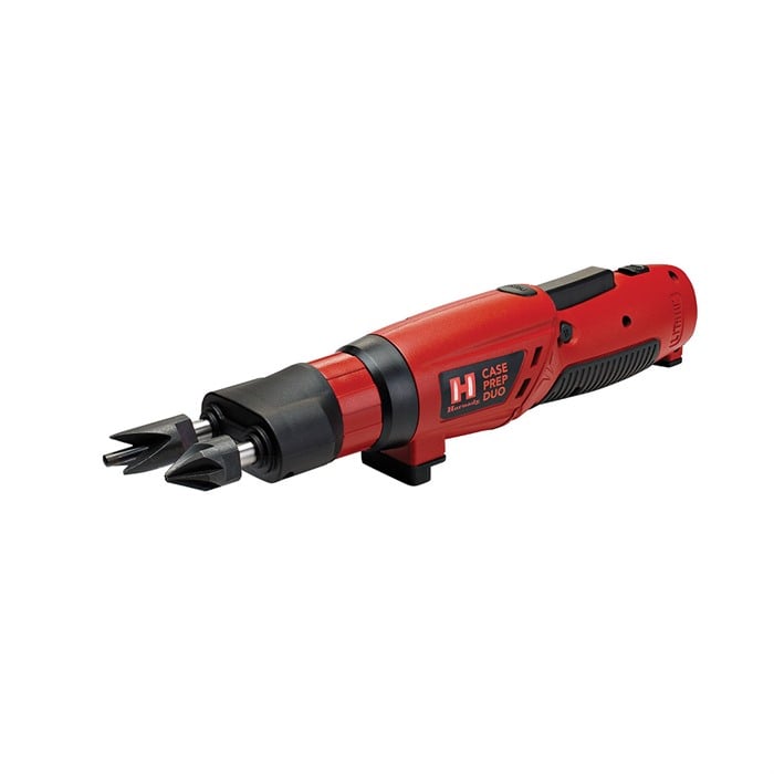

Yes, though I run it with the 1/4" drive that they make with either my Hornaday "Case Prep Duo" or just in a 1/4" drive screwdriver {slower than a drill}
I must say that the Hornaday Case Prep Duo is the handiest tool as I can quickly lightly de-bur case mouths after wet SS pin tumbling {always a factor, especially for small, lightweight cases such as .223 or 6BR}
Tumbling can slightly peen the case mouth and if you don't de-burr them you can wind up with a slight trumpet mouth when seating you bullets and wind up at the range with rounds that will NOT chamber...!
Been There... Done That....!
Amazon through all the major suppliers to our hobby have them just under $50...! Best bit of kit for the $ and you can sit and watch TV with a tray in you lap to catch the brass shavings... {:~)
