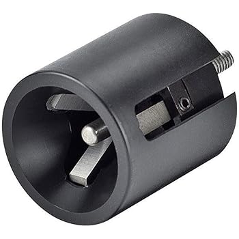

I found a VLD cutter for deburring inside case mouths. This is the 3rd inside cutter I have put on this Trim Mate. I need a new cutter for outside deburring. I have been unable to find anything that will screw into the Trim Mate. I am about to cut my good deburring tool in half and thread it to go on the Trim Mate. Deburring 500 cases by hand takes tool long, and the skritch skritch skritch sound it makes drives the wife and dogs about crazy. Suggestions.
I got a new one 2 weeks ago, I had to order the carbide replacements for inside and outside, midwayusa , the other ones not the greatest.
I put the Lyman version of both tools on my Trim Mate. They come with an orange two piece handle so you can use them that way as well. But the thread fits the Trim Mate fine.

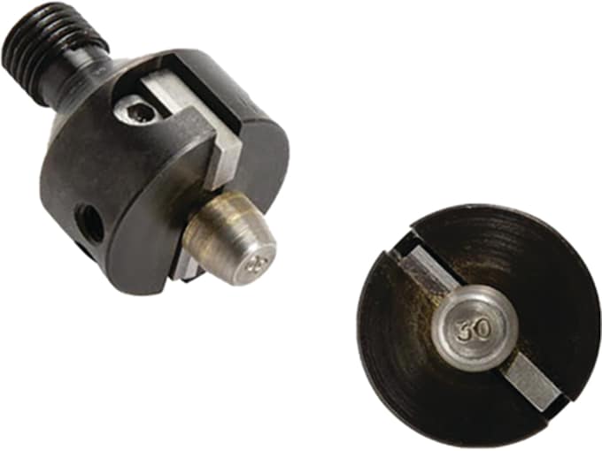

I had the older 3 way cutter but didn't like it and was thinking of getting the newer VLD 3 way cutter. Is this the one you're talking about?
https://media.mwstatic.com/product-images/src/Primary/738/738460.jpg?imwidth=680
The RCBS Trim Pro Case Trimmer 3-Way cutter is a unique two blade head configuration that trims cases like a standard cutting tool but also chamfers and deburrs the case at the same time saving valuable time in the reloading process. Will attach to RCBS Trim Pro and Universal Case Prep Center. The 22 degree angle of this VLD cutter allows the bullet to be seated into the case without damaging the boat-tail and ruining accuracy.
RCBS Trim Mate Carbide Chamfer Tool. Works great and fits the Trim Mate.
