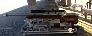

I use this method and target that I designed - with tuner at zero setting zero scope for POA/POI
I then shoot 3 shots at zero setting then 3 shots moving 5 adjustments at a time. I skip the 3rd shot if the first two do not touch each other.
Here is an example of a tuner test with a factory barreled Anschutz 54 1413 (Harrell's tuner lightened to 4.5 oz.) this was in 2019 this same year at the Mesa center it produced a 11.86mm 10 shot group off a Pappas rest. the same 90 tuner setting is still being used today. it resides in Colorado and is shot in local matches for the last 4 years.

not as experienced as most of y'all but i shoot a 5 shot group no tuner then 3 shot groups start at zero then moving it out 1 full number turn( Harrell's tuner) ie 100, 200 300 ect then look at the groups . find the best group and shoot 1/2 way in-between the numbers and reshoot and repeat both sides to see groups.

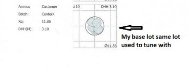

What I see in your target is the same sine wave as this from gunsandgunsmithing:
And it still seems to me that the best place to be with a tuner is at the node of the wave. :rolleyes:
That is good that you know what to look for. a few shooters seem to make it difficult for them when trying to find a setting. to keep things simple anyone who ask me on what they should be accomplishing when setting a tuner, I tell them it is all about bullet exit timing. all you are doing is using weight to adjust that exit and you want it to be at the top and right of the barrel's movement.
Something my mentor earnest (Marty Hammond) from RFC had explained to me more than 10 years ago.
Lee
Yeah they would all laugh at you.
Yep! I get the pc aspect but otherwise, I don't see any difference rf vs cf in this regard. PC is there with or without a tuner and with both rf and cf. I truly feel people make this much harder than it is, mostly by randomly moving the tuner in some large increment, without a known reason for whatever increment they use. Doesn't matter what tuner...ya gotta establish increment values. Without knowing what to expect, you're simply moving and hoping. That's not what I'd call a methodical approach but hey, if it works for you, don't change a thing.
The test target above, albeit cf, shows top and bottom of bbl swing, how many marks from top to bottom as well as how many between extreme in to out of tune and group shapes that I look for. Those shapes are predictable and repeatable! That's the basis for how I use a tuner. Without that predictability, it would not work. It's not only about the smallest group on the test either, as one thing confirms the other making it very statistically significant without firing thousands of rounds and such as that. For example, tuner setting 0 looks good but I would not use that setting as the next couple of groups do not display what I look for nor is it at top or bottom of the swing. There are reasons for those somewhat random small groups but they are typically very tune sensitive or just won't repeat...err, hold tune. I like setting 2 or 10 of that test with 2 being at top and 10 at bottom. In SR CF, I'd probably go with 10 because the next couple of groups are absolute textbook as far as what I look for along with poi being at bottom confirming being at an anti-node, which IS what we want. See how one thing confirms the other? For LR and RF, I'd go with 2 because of PC and not having control of ammo velocity ES with rf. PC can only happen on the upswing. I like 10 because it speaks to me, loud and clear, more so than 2 but will be more sensitive to ES of the ammo and at distance. Those things are of little consequence in SR CF but they are in RF and LR.
One last thing...the test also tells me which way to move the tuner if I see specific group shapes as tune goes away. See 10, 11 and 12. Beautiful, textbook example of what I look for and preach...for about 15 years now. 2,3 and 4 are NOT a wide spot. They are an example of the gun creeping out of tune but still shooting just well enough to lose.
