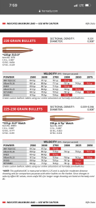

Agreed, but usefull. Hodgdon has data for IMR 4955 and covers bullets from 150 grs to 212 grs. This burn rate is better suited to the heavier bullets. IMR 8133 Hodgdon Data. 20201010_104820.jpg
