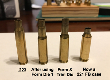

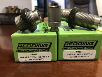

I have been using 2 Redding dies to first form the 223 to 221 FB.
1. Form Die #1 (90101)
2. Form & Trim Die (83101)
After using these two dies in this order, I have a very long neck 221 FB case. I give it a rough trim and then trim it to length, chamfer inside case mouth and de-burr outside of case.
Anneal the cases and run them through the Redding body & FL dies to bring them to the 20VT case standards. (I remove the expander from the FL die)
Then I use the expander mandrel from Century 21.
Next I turn the necks on the Century 21 neck turning lathe. Make sure you use a lube on the mandrel.
You're now ready to add primer, powder, etc.
I don't think I left out any steps on this.
There are several steps in this process, but the .223 brass is so cheap plus I'm retired, so it's worth it to me.

These are the 2 dies and shell holder used when starting.
This is what your case should look like while going through the steps.
