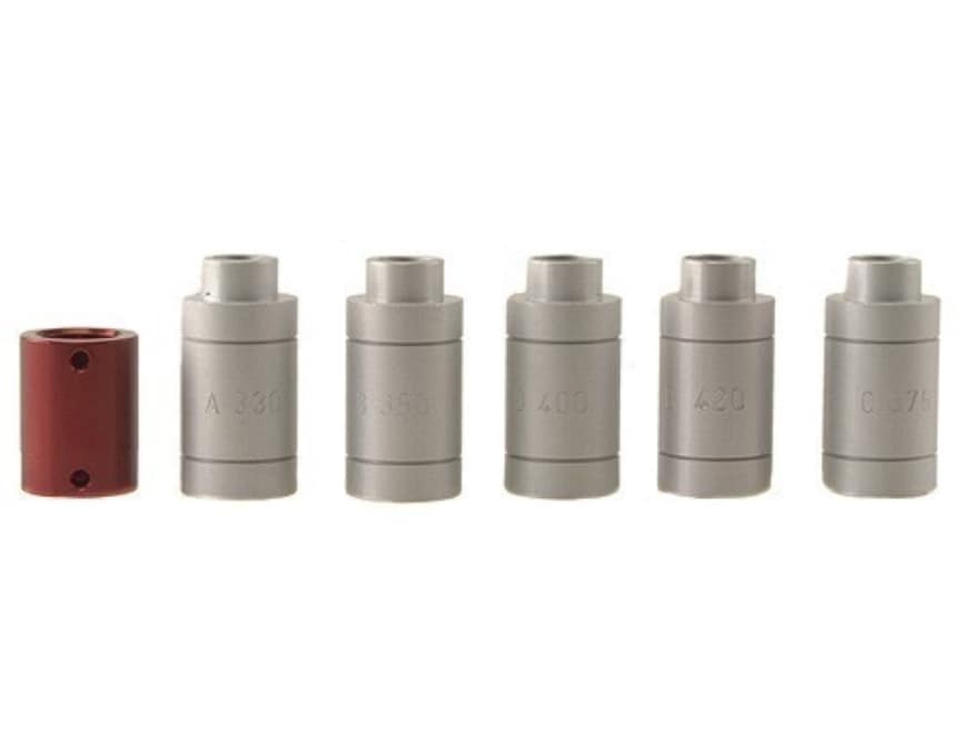

Am I the only fella using Hornady Lock-N-Load Headspace Comparators?
I even use a (GASP!) digital caliper. Measure fired cases, average headspace fired, set die to consistent -0.002" size, pull handle many times.
NO you're not the only one as I also use one . MY mistake I should have stated Dial and Digital calipers ,as that's what I use . Correct tools wrong terminology MY bad .

Just to add to that, many of the problems and issues like those that arise on this thread are due to the tool being misleadingly / inaccurately named as a 'Headspace Gauge'. It is NOT a headspace gauge as several people have pointed out in their posts - it's a case shoulder position comparator - no more, no less. A very useful device, but purely for determining sizer die settings to obtain the correct amount of shoulder bump purely for one rifle's chamber. It can have a secondary use in measuring new brass out of the box to allow comparison with fired examples - that's how I discovered that Lapua 6.5mm Grendel brass shoulders are 0.009-0.010" 'short' of an ideal setting for my rifle, which starts to be a 'headspace issue', and sees me treat first use as a 'fireform job' loaded to put the bullet in the lands.
