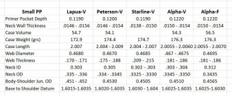

The main differences I found between the two (Lapua and Starline) is that Starline has substantially thicker web and the neck wall thickness was thinner. Along with that I found the virgin case volume to be to be pretty consistent and average 54.0 grs of H2O, .7 grs less than Lapua. Keep in mind this only has to do with the particular cases I have and measured, since such numbers can vary from lot to lot where there could be greater or lesser differences. But, I think the difference in web thickness isn't going to show much change.
In terms of performance, I feel they can perform just as well as Lapua, but it might take a little more effort in brass prep. I say that because on inspecting these 10 cases, 3 of them has very visible burrs on and in the flash holes. And when I deburred the whole lot (with a 21st Century flash hole deburring tool), I often got quite a bit of shavings. If there's more variation in the neck thickness than I found in the ten, that could be an issue too. That the Starline and Lapua primers pocket depths were the same is good. . . in terms of comparison.

Substantial peening and burrs on virgin brass requires some attention before first firing.
