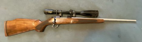

Sako AII, Hart barrel 23-1/2", now braked since that picure was taken. Chamber 6BR 14tw, .271nk 0 fb. Likes 2230 powder and 55/58/65gr bullets. These things are amazingly accurate.
I have a Sako A11 22/250 and the barrel is getting long in the tooth. I will get it rebarreled this winter and will be doing just as you except I may go with a 12 or 13 twist I had my reamer made by Manson and it has 0 FB as well. In my last 6BR if I would have had .060 FB I wouldn't have been able to get to the lands with the 64 Stinger or the Berger. At least not enough bullet left in the case to make things work let alone chasing the lands . JME
