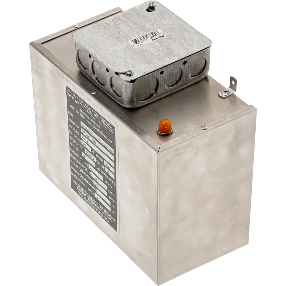

I run my Logan on a Grizzly. My Logan is a beast and it runs great. Grizzly actually sells one that they have made in Missouri. I have no complaints. I don't know why you're calling it a poor choice.
I'm glad that you are happy. I don't like that for one, they are 70% efficient. I can send you the steps and help turning yours to a rotary.
That's cool. All I can say is it was super easy to hook up I haven't had any problems and my lathe has amazing torque it's a five horse. So, it works great and I've never had any problems with it. I really don't think it's poor choice. I'll just say that.

I had 3 phase at my old shop. Now I run my stuff on a Phoenix rotary. I almost feel like the lathe is even smoother. Id say to get one twice the size as your largest motor. Super easy to hook up and runs quieter than my lathe motor. When I bought my new lathe I was told a static converter will void the warranty. Why, I dont know.
They only get the motor turning with 3 phase by use of a capacitor. Once it's running the motor is crippled and running single phase. I can't imagine it would be very smooth
