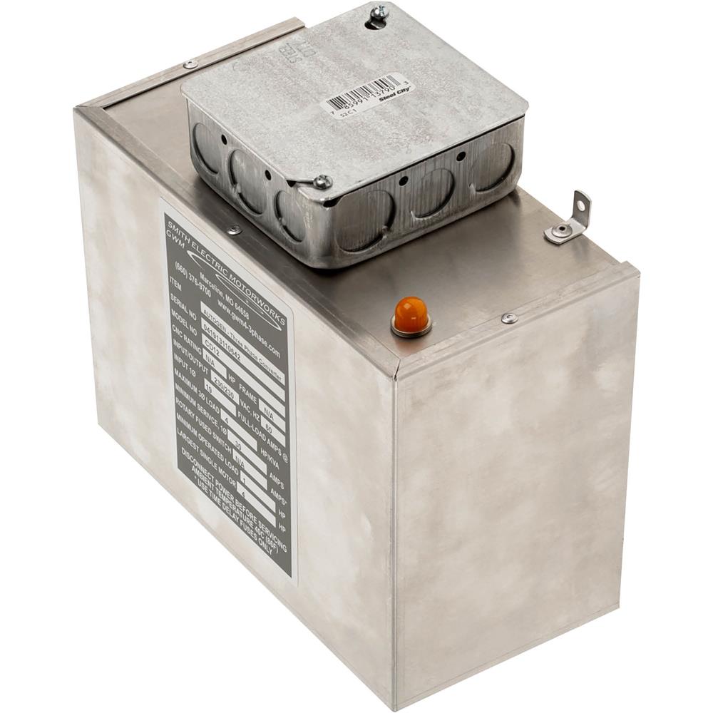

Simplest solution would be to run it off a rotary phase converter. Many times you can find a used one floating around. Looking at a schematic it looks like the pump is 3PH as well as the spindle motor. Controls are single phase off of two of the legs to a transformer so that shouldn't be a problem. VFD the spindle and ignore the pump or replace the pump or run another smaller VFD for the pump.
Run it on 3 phase. It doesn't cost much to do it. Then run VFD on 3 phase. I think it is worth the cost. I would do it. Cheaper than change single phase over to 3 phase.
Thanks WSnyder for the schematic! Seems like a reasonable approach. I did purchase the lathe. I’m at a Gordy Gritters class in Florida on chambering and decided I better get a lathe !
Cheek9075 … I am not sure I understand your answer. Wish I had three phase in my garage/shop, but I only have single phase (residential). Thanks for the reply.
My .02 if you are going to add more 3 phase machines mill, grinders band saw ect I would get a rotary and power them all. If the lathe is the only 3 phase pc get a VFD. Don’t sweat the pump once you get everything set up your going to want a flush system anyway. Just get a single phase pump and power independently of the lathe control.

There's some information on a website called VFDs.com. It said a VFD may not play well with peripheral stuff like a contactor. I didn't want to spend money on a VFD and not have it work right so I went the rotary phase converter route.

Just get a rotary phase converter. I use to use VFD'sv but went through several machines before my current setup and got sick of re-wiring everything. A rotary takes the hassle out of 3 phase. VFD's are nice but only for one specific machine. I have two brand new ones sitting on my shelf, after I got the rotary I never touched them.
I have a 11 hp Roto-Phase set up at my son's garage. A mill and two
lathes are run off it. Dumb ass me sold off the Harig grinder when I
retired and closed the shop. Looking for another, and it will plug right
in......Note about the rotary phase.....We had to relocate the drive to an
outside utility shed. The whine was a bit much as the day went on.

Both of my rotaries and my compressor are outside under a little covered area.
