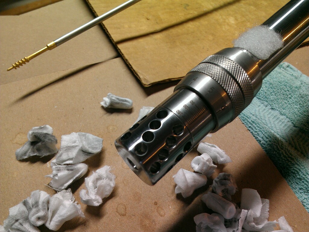

Chuck: I just put the exact same tuner/brake into use on my Krieger barreled 308.
First fired a couple groups without the tuner, just the brake alone & all was fine. Then installed the tuner & lock ring, started at the most forward position, 150, not good, back to 100 a little better, back to 50, not much change then forward to 75, and hit the jackpot, (for that load). Then ran the identical load except with IMR 4064 instead of the previous Varget and that "best" number is 65. Chonographed velocities of both loads are the same, 4064 has lower SD & ES numbers.
Been using a rubber strap wrench to remove & install, also to tighten the lock ring, & it works fine.
